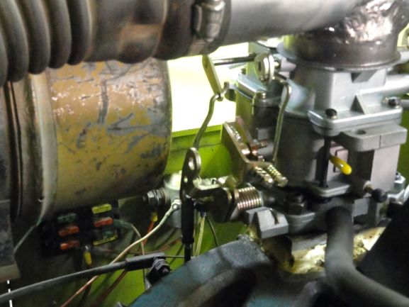

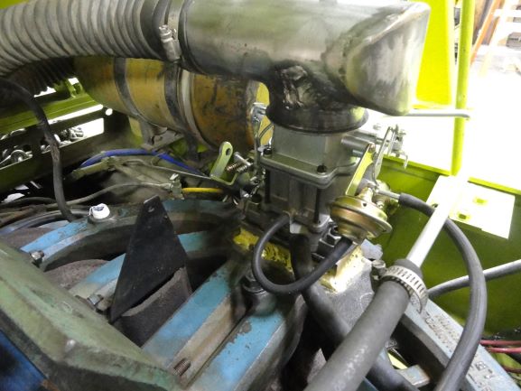

Been reading and researching on here quite a while and cannot find a solution to my problem. Anything I do with this forklift carburetor is frustrating!!! Engine is totally rebuilt and I modified a single barrel intake into a 2 barrel sideways cause I heard they distribute the mixture better and my linkages will work better. I got a cheap Chinese Carter BBD carb off Ebay and It works but not good. The accelerator pump comes on too late and there's no way to adjust it that I see to make it work right. What's the best carb off ebay that works right out of the box? Or should I just go to a fuel injecton setup? I have a machine shop so making anything is not a big deal. It has to idle low so when I shift it in gear it doesn't slam too hard. That's where I need the accelerator pump to come on right away. With the carb I got now the pump doesn't squirt till about 1/3 throttle and by then its already stalling out. I've already broken 2 axles by it slamming into gear cause it idles too high and I don't want there to be a 3rd.

I think I may have figured out a idea. I've got 4 old single barrel carbs and one had a rod with a 1/8 slot about 3 inches long. I think I can rig up a linkage that will go through the slot and pull on the pump first, and then when the slot bottoms out on the butterfly linkage it will open the throttle blades. Never really thought of that cause I've never seen a direct linkage right on the accelerator pump before. Instead of having holes through the throttle blades this carb has holes just above the blades to the outside of the carb. I don't like the holes to unfiltered outside air. This would be a big issue if I still lived on gravel but since I'm in town now I don't think there's enough dust being stirred up regularly to destroy the engine. The high idle is a little better and I think when I get the linkages done a little more spring pressure will help that out also. Ill post a pic when I get the linkages done.

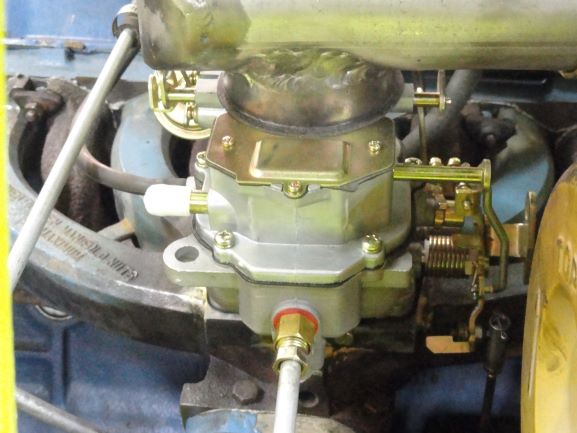

I got another carb for my forklift. This one works better thank goodness. It has quite a few ports on it that I had to plug I think. There is very little stumble after the throttle is opened. The accelerator pump comes on almost right away unlike the other carb. I don't know what all the ports are but I plugged most of them except the one for the pcv valve and the one that goes to the vacuum advance. Hopefully I used the right ports. I'm also running the needles about 1-1/2 turns out and that feels close but not quite sure.
