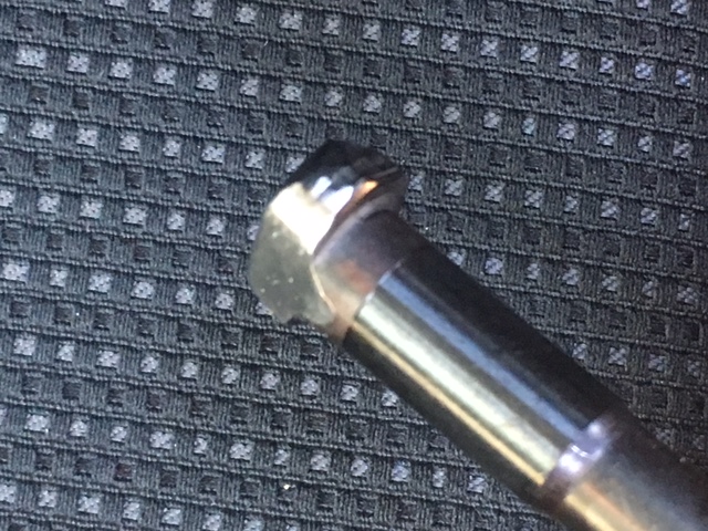

I've read in other threads (which I can't find now) about ARP rod bolts having an interference issue with stock rods. I ordered a set of the ARP 142-6001 rod bolts for the Slant Six and sure enough...they don't fit the rods properly.
The inner side of the bolt head needs to be ground away in order to allow the head to rest squarely on the rod's surface. Without the grinding, only a small portion of the rod bolt will contact the rod...could well lead to a failure over time and heavier loads. The grinding needs to be done so that there is no shoulder (or 'lip) on the inner side of the head.

The 6001's are the rod bolts ARP lists for the pre-cast crank engines so it's not a part number/application issue.
By 'interference' I don't mean the light press fit that occurs around the shank of the bolt. I mean the rod and bolt do not interface properly; the bolt has too much meat on the inner side and that prevents the bolt from seating fully. I'd take a photo but the rods are at the machine shop now. The original rod bolts have no shoulder on the inner side; this allows them to fit as intended. But the ARP's have some inner side shoulder and that is the problem.
It's good that ARP offers the bolts and not big deal to relieve them - but if this is overlooked (and I bet lots of people overlook it) then it can be a definite weak point.
As for the shank press fit, the stock bolts had very little - maybe 200 lbs. The ARP's are tighter with around 750-1000lbs. which I'd consider 'better'.

Doc mentions interference with new con rod bolts (not ARP specific) in the engine assembly thread:
"If you have new con rod bolts, now is the time to install them. Always check to be sure the new bolt heads clear the bolt head cut-out on the rod and sit flush on the surface. (some clearance grinding may-be needed to allow the bolt head to sit flush)"

I used ARP rod bolts in the stock rods that went into to 83 D150,
Probably 5 years and 30k miles ago, I don’t remember grinding the bolt heads to get them to fit.
Maybe the interference is a forged crank - rod issue.
