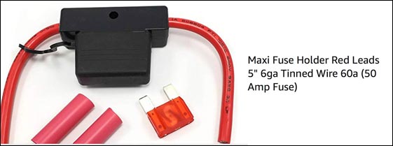

“You can do it quickly and cheaply by running two 10ga wires with ring terminals at each end directly from the alternator's output terminal to the battery + terminal. Each of these 10ga wires must have two 50A fuses, one located within inches of the alternator output terminal and the other located within inches of the battery + terminal.”
Okay, this makes sense. Questions now... I’m finally ready to do this thing...
1) Ring terminals and fuses — any suggestions for specific parts (e.g. fuse holders)? I'm at a loss. For the fuse, are we talking about something like this?, with one lead at a ring terminal and the other connected to the 10 gauge cable? https://amzn.to/2LwEDVV or illustration
File comment: Fuse
Yep.
