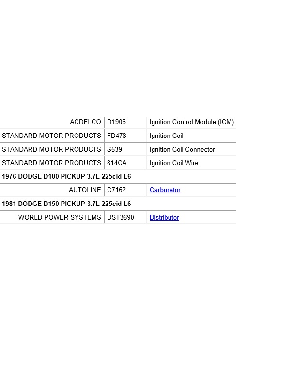

It's been a busy couple of weeks for the old D150!
I ordered a carb, distributor, and the HEI parts from Rockauto.
It all went together well, with only a few issues.
1. The AC DELCO ignition control module failed after two days. I ordered another and it's still working.
2. Setting the timing was a real chore. This motor is very, very touchy. A couple degrees either way from the "Sweet Spot" and it won't run at all.
3. I had to fabricate a linkage arm from the carb throttle to the transmission kickdown. I used 8/32 threaded rod, four nylon lock nuts, and made up some bracket ends. The linkage is adjustable, more on that in a minute.
It's a little rough at cold idle, but once warmed it runs great!
About that linkage: is there a guide to proper adjustment?
When should it "engage", as is when and how much when the throttle is moved?
Thanks again, you are all a great resource of info to keep these on the road!
