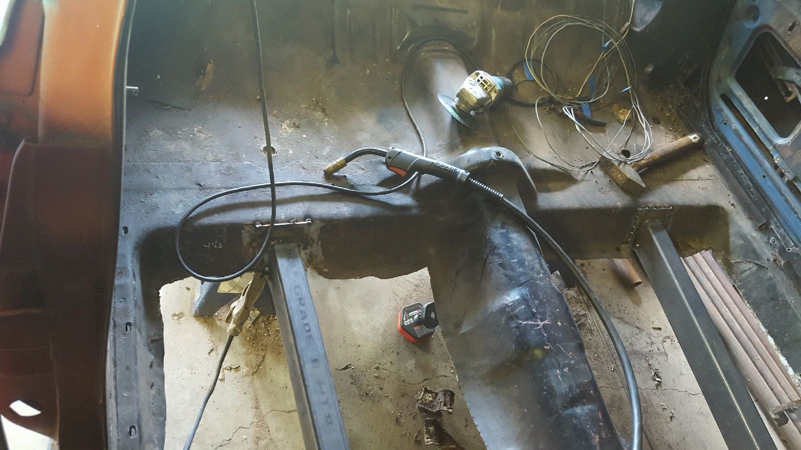

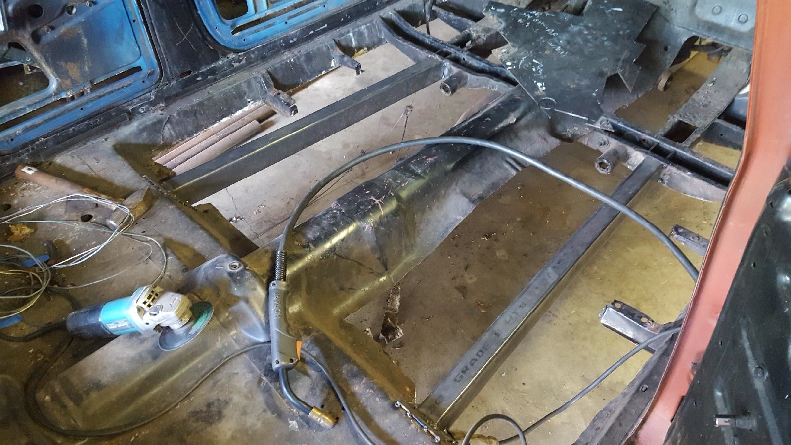

Adam tacked in the subframe connectors.

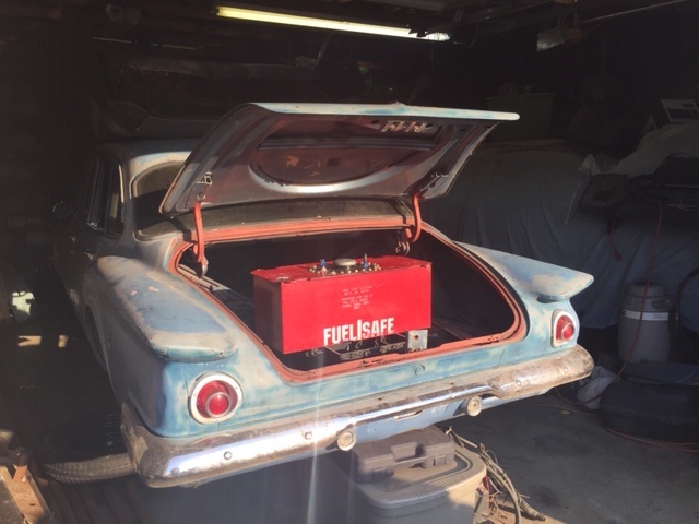

Jason and Whitney drove all the way from the Atlanta, GA area to donate a racing seat, fuel cell and four speed floor hump! Thanks!!
File comment: Torsional rigidity at the cost of added weight... ;-)
File comment: Notice the thorough (not yet complete) undercoating scraping going on... It offsets the weight of the frame connectors... ;-)

Cool. See if the rules allow a sheet aluminum floor pan (pop riveted). That would also offset subframe conns. Let's keep it light! How big is fuel cell?
PostPosted: Mon May 20, 2019 12:52 pm
Posts: 9109
Roger that! Lighter is more gooder! I think the cell is 10-12 gallons. The seat is a Kirkey Fat Boy.

What is preferred for fuel cell location as far as weight distribution - lower but rearward (spare tire well area) or higher but forward (under the package tray)?

I'm just an old circle track racer but I vote low, behind the axle.

Low and rearward, for me. Need to get/keep weight toward the rear of the car for balance. I cut the spare tire well out of the two I have done and hung it just behind the shock mounts, flush with the original main floor. Watch for axle pumpkin and shock clearance.
