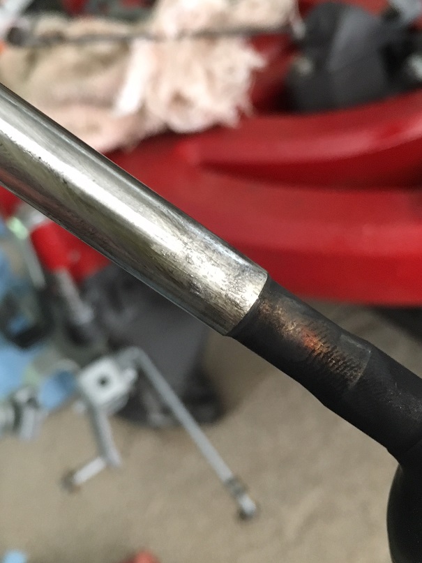

The 225 was running great. I had about an hour of total run time on the engine, maybe a little more. I drove down the street a half mile, then turned around to go home when it started running very rough, as if a few spark plugs had exited the confines of their dwelling. I was pretty sure I had tightened them down, however. I rolled home, did some poking around, and ..... under the valve cover I noticed one of the fancy new pushrods (#6 Exhaust) was no longer where I had left it. Nor was the lifter.
I did some further checking, quite sure I had more or less tightened the rocker assembly as planned. Then I noticed the exhaust valve itself was still down, even though nothing was pushing it down. I pretty much knew what had happened by now.
After removing the cylinder head...sure enough, the valve was stuck open. I took off the spring and was able to tap it out with a mallet and could see the guide had run dry of oil which led to the usual galling of metal.
When I had discussed the head work with the machine shop, they recommended new silicone seals. I told them they 'could' use them but was just as happy with the stock umbrella seals...I didn't care if the engine used a little oil if it kept the guides lubricated. We agreed they would use the stock seals...but when I picked up the head I noticed they had used the silicone seals after all. I didn't complain, figuring I was being too fussy and that the seals they used would be OK. Well, they weren't! lol.
I haven't looked at the other valves but I am guessing the exhausts will all be in bad shape. My plan is to go back with new valves and stock seals....

 Post subject: Re: 225...it dies!
PostPosted: Sun May 26, 2019 8:24 am
Posts: 1437
I have used those type of seals on big block Mopars with no issues. I actually have those style valve seals on my race engine, but I haven't started it up and broken it in yet.
I would be curios to know the root cause of your issue.
PostPosted: Sun May 26, 2019 8:51 am
Posts: 13278
My brother had those style of seals installed on a slant head he ran on the street for a few hundred hard miles. No problems.
I would be interested to see if the rocker arm shaft was installed in the correct orientation. Pre 77 or 78 rocler arm shafts can be installed upside own with the rocker arm oiling holes pointe the wrong way. This leads to much less oil reaching the rocker arms and dribbling out onto the valves. I suppose it is possible that this caused oil starvation and the galling you have in the valve stem.
PostPosted: Sun May 26, 2019 9:10 am
The shaft is correct, and there was plenty of oil up top. On this engine, I had grooved the cam journal and ensured all the passages were 'wide open'. When I primed the engine, lots of oil was flowing on the rockers even with minimal pump RPM.
I've used these seals too, but (from memory) a V8 has a shorter guide. And I have only personally used them with bronze guides, not iron. All I can say is the seals fits so tightly that I don't see how any oil gets down the stem...it's like a wiper (spring loaded to boot) that will remove almost all oil from the stem.
PostPosted: Sun May 26, 2019 1:54 pm
Posts: 17298
I have used Teflon seals that looks like the ones you have and never had a problem. I would suspect they set the guide clearance too tight?
PostPosted: Sun May 26, 2019 2:20 pm
Posts: 14770
I personally don't like those seals, especially on the exhaust side. I tend to run no seals on the exhaust side and umbrellas on the intakes.
PostPosted: Sun May 26, 2019 7:19 pm
I didn't measure the guide clearance...but it felt good and of course the machine shop said it was 'right'. The problem happened right where you'd expect - the bottom of the stem on the thrust side. It's easy to imagine the oil being less there, the load the highest, and the heat from the exhaust helping cook away the oil.
I didn't mention before but these guides are iron (not bronze) replacements that have the rifle groove running down them, which is meant to provide better oiling. Of course, if they don't get any oil it doesn't matter if the groove is there or not.
I guess my gut feel is what it always has been....the silicone seals are too effective and don't let enough oil by. I mean...they are wiping the stem very efficiently, especially when new.
I'll be interested to see what the other valves look like. I might pull them tomorrow if I get in the mood though I kinda prefer to let the machine shop do it so they can see for themselves.
PostPosted: Sun May 26, 2019 8:01 pm
Positive seals are good on intake valves which are relatively cool and have vacuum to help draw in the oil. They do keep oil out of the combustion chamber. Good for a race engine. The exhaust sees little, if any, vacuum and runs hotter so it needs more lube. In this context is easy to see why exhaust umbrella seals are shorter than intake umbrella seals. My 1956 Dodge hemi wasn't built with valve stem seals on the exhaust side as the stems are essentially horizontal. Oil does not run down the stems and pool on the tops of the guides.
That valve needs to be replaced as the stem surface is rough and will tear up the guide.
