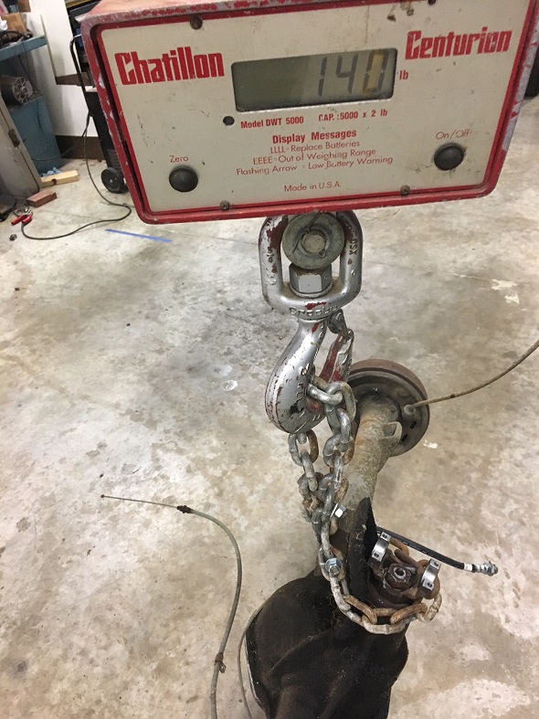

I pulled the 7-1/4 out of the Valiant tonight...after 52 years of service it's headed for the differential rack outside.
Though I'm a fan of the 7-1/4, I'm changing to an 8-3/4 for a few reasons.
I have a big pile of 8-3/4's I need to make use of before I die
I wanted the big bolt pattern
I have a bunch of third members with different gear ratios already
But....the 7-1/4 has some distinct advantages...it weighs less and rolls easier. For the average A body with a Slant Six..it's plenty of rear end.
So, when I get the 8-3/4 all together I'll weigh it for comparison. I'm expecting it to be about 60lbs. heavier. That's serious poundage. Here's the complete 7-1/4 - brakes, drums, parking brake cables, etc.

PostPosted: Wed Jun 26, 2019 3:13 am
Posts: 17675
60 lbs is about right. If there were strong limited slips and gears available for the 7.25, then I would have one in a car.

PostPosted: Wed Jun 26, 2019 5:14 am
So the later vehicles that used the 7-1/4 don't provide a source of parts? Like, didn't some Dakotas use the 7-1/4? It seems like trucks would have used Sure Grips, etc.
Then, there's the added weight that comes with the bigger tires/wheels you migrate to with the bigger bolt pattern.
The only saving grace is that if you have to add 60lbs. to the car, the rear end is one of the better places to add it....at least it's not over the front axle. But, it is unsprung weight which ain't good....

PostPosted: Wed Jun 26, 2019 10:27 am
Something you never hear anyone talk about....pushability.
I can't push my truck in the garage 2 inches. I could push the Valiant pretty easily. The Chrysler, somewhere in between. That's gotta tell you something about how much power a car wastes just moving itself. I'm sure when the 8-3/4 in installed, my Valiant will take a hit on pushability.

PostPosted: Thu Jun 27, 2019 2:31 am
Posts: 17675
8.75" is about the same wt as an 8.25". Maybe 10 lbs heavier?
