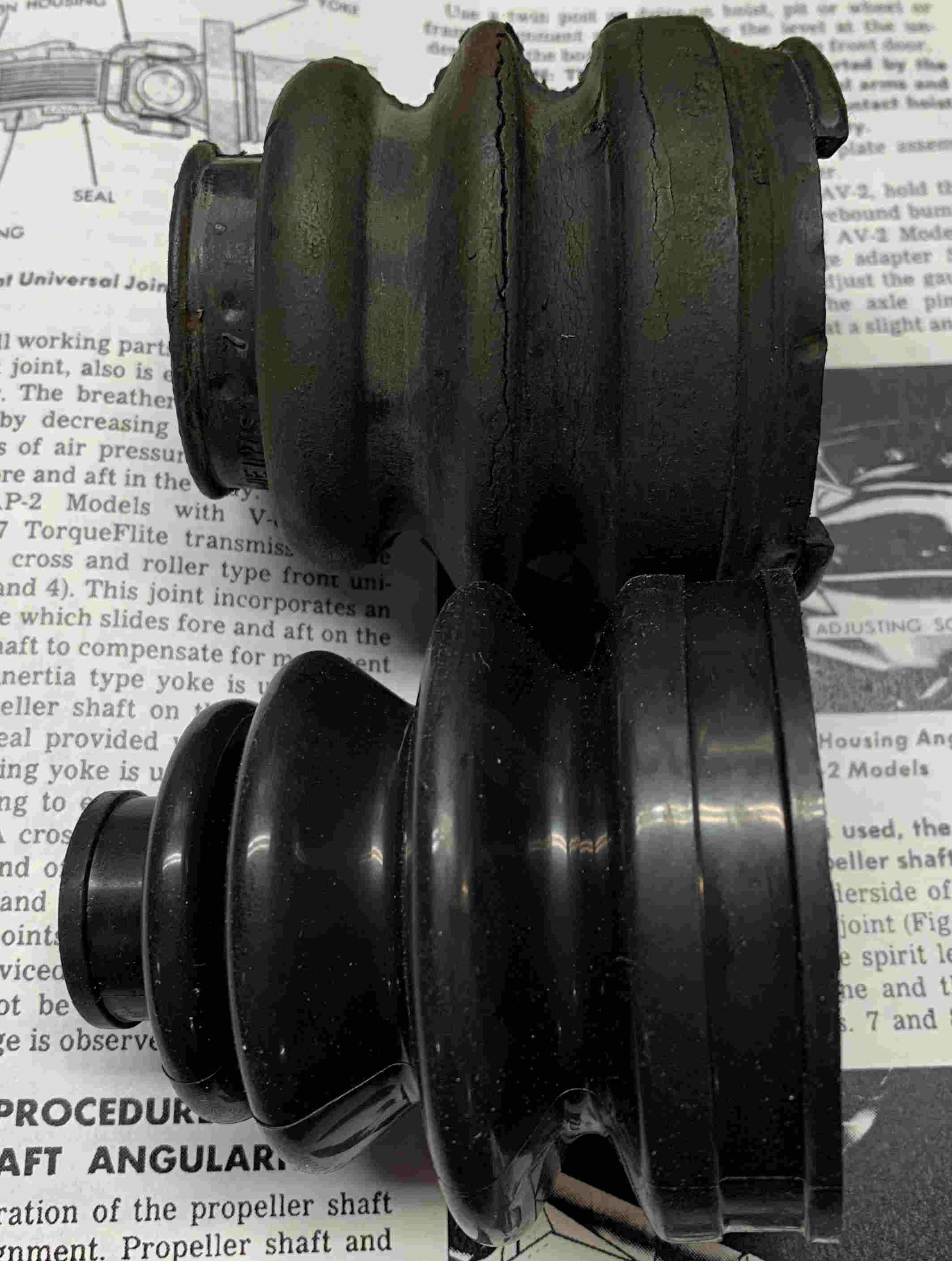

Dried up output seal and resulting fluid leak led me to my latest adventure, replacing the output shaft seal on my 1965 Valiant's a904. This seal (TF6 CT6392 12925A or # 12925A), didn't last long and I thought I'd give this seal (National 472466 Oil Seal) a try. Cheap and easy solution is what I strive for. Trunnion boot was ripped and so I thought this was a good opportunity to get that fixed up as well. I can't speak for anyone else's experiences, but all this talk I've run into about needing a press to disassemble the Trunnion joint seems silly. I found that it has a bearing surface and simply pushed out with a small vice. Removed the pin and replaced the old cracked boot with a new style CV boot, it needed modification but ended up working perfectly. Simply trimmed it with a razor blade. (All Balls 19-5008 Black 17mm x 60mm x 81mm Long CV Boot Kit) https://www.amazon.com/dp/B019QFHRZA/re ... hDbYAX241F

Thanks. I'm going to try this on my 64 Valiant 3 speed stick. I usually convert to a "normal" U-joint, but don't have the funds right now. Don't like to use NOS boots, as they are so old the rubber doesn't last.

Thanks for the trunnion boot tip. Ordered one up, hope it fits my 64 270, looks like it will. I got a "stock" one a while ago and it disintegrated very quickly.
