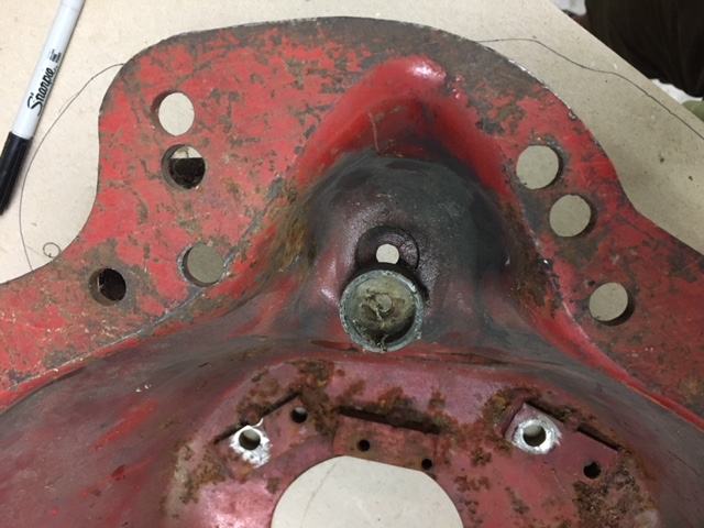

Rick, I looked at 4 bells I have and only one has the dual holes. It's a big block bell. But, in looking at it I realize it is only useful to this discussion as it shows that they considered two different flywheels and the resulting starter locations.
That's because this bell is set up to handle the normal 11" big block flywheel and also the early 426 Hemi flywheel that used the direct drive starter. Those parts are all unique to the early years and no one uses them now unless they're staying original.
You can see the two sets of holes, and how they are not even spaced the same. The direct drive starter has a different spread. You can also see how they accounted for the two different snout positions with a cup that can be moved.
