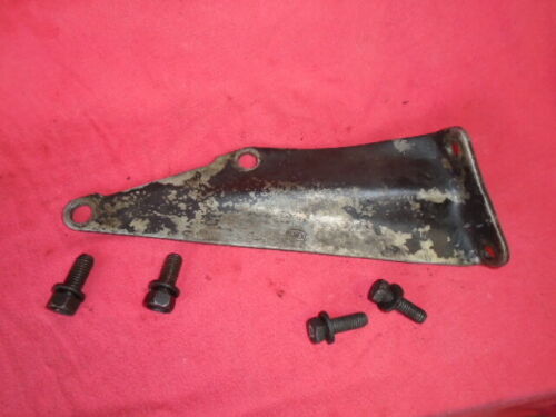

I should know this....but I don't. This bracket is for an automatic trans-to-Slant six block. Does a manual trans use a different bracket? Or the same?

Not positive but I think they are the same.

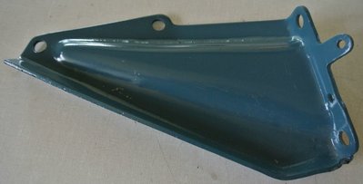

There is a wider one.
It has a tab for a return spring.
Manual Transmission.

PostPosted: Fri Dec 20, 2019 12:08 pm
Thanks! I recognized it the minute I saw your photo. Now I gotta go see if I can find one...

Posts: 10437
They are different.
If you only had an a904 auto bracket you could cut and weld it into a manual trans bracket if you really needed to.
