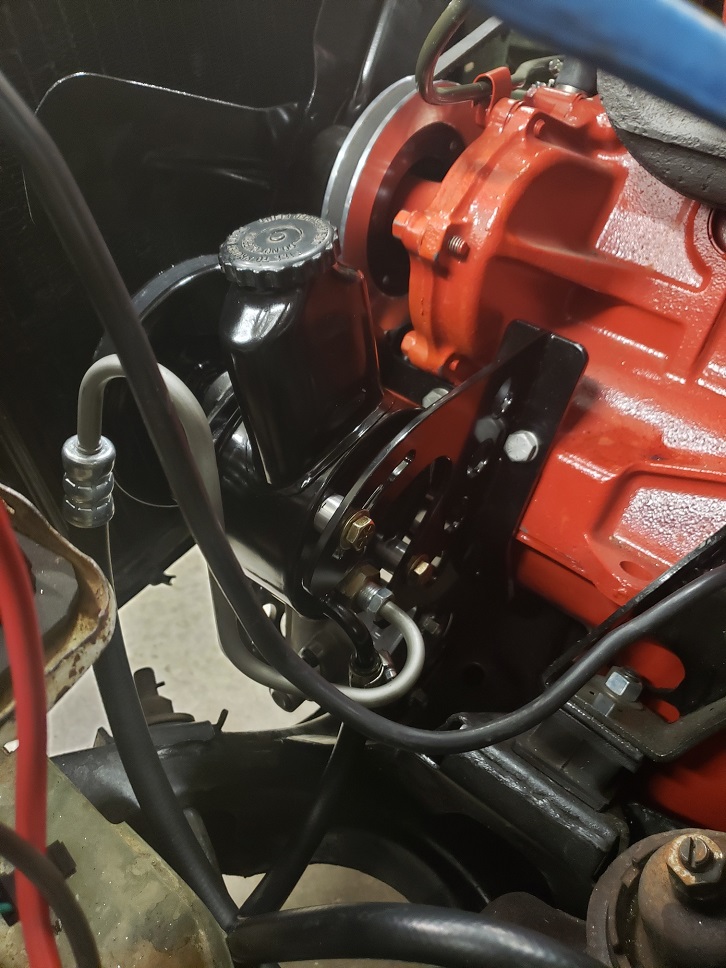

PostPosted: Sun Jan 19, 2020 4:35 pm
Thanks everyone.
These pics show the trans in the car with the hoses installed. I'm still waiting for some material to make the clamps I want, and some exhaust shield, so ignore the hose clamps on the exhaust, etc. The small black hose coming out of the bell is the pressure side of the TO bearing and the other hose is the bleeder. Then, the larger black hoses are the suction and feed for the trans itself.
The engine shot shows a bit of the hydraulic master cyl.
The shaft....always been the hardest part of this project. The stock Mopar shaft uses shaper-cut splines on the small end, and rotary cut splines on the big end. I don't have the ability to do the shaper cut splines...so I made a CAD drawing and had a local gear shop make the shaft out of 300M steel that is normalized and heat treated. Let's just say by the time all that was done, the shaft cost as much as I bought the car for!
As for speed....I'd guess in 1/4 mile the clutchflite would win. Especially if the engine were bigger and had no need for more gear. Even with the Slant, I think the faster shift, and one less shift, would win. Then, I'd be surprised if you could actually use all 4 gears of an 833 in the 1/4 unless you had some steep rear gears.
