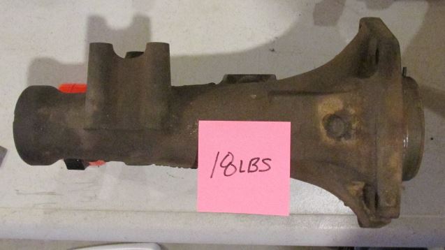

I have one I will sell. Where are you located? Do you know which extension housing is on your transmission?
Mine looks like this one.
