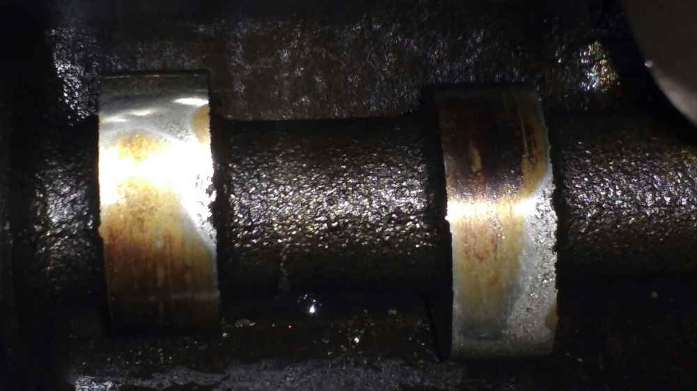

The rod knock was very definitely the #6 rod bearing. My suspicion is that the pick-up was not letting enough oil through on the high RPM dyno pulls. The crankshaft looks like it could probably be turned undersized and saved. The rod, probably not.
Also, the cam lobes aren't looking in the best of shape.

Yeah,... I’d say that con rod bearing is a bit hammered.... :shock:
yes from the photo that pick up screen was blocked, for the next motor you may want to look at the
oil pump porting mods that Doc has posted here, nothing terribly crazy, but every little bit helps,,,,
