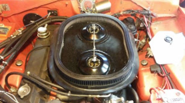

PostPosted: Thu Feb 27, 2020 4:39 pm
Posts: 2721
Do this air cleaner mod, this looks great. IMO
