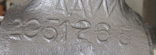

I have what I think is a 198 crank.
Here are the casting numbers from the casting number charts:
And a picture of my crank, 2951265.
This seems to be a combination of both the 198 cranks listed.
Anyone have the same casting number as mine?
Any ideas on the unlisted number?

A 4 not well stamped can look like a 1.... :?
I hear what you are saying, but you look at that 1 on my crankshaft. I don't see how that could have been a 4.
PostPosted: Thu Mar 05, 2020 1:42 pm
Posts: 9167
I agree...
John's suggestion of measuring the stroke is a good one.
That chart shows that the 170 and 225 crank part numbers are nowhere close to the 198 numbers....
And the strokes are far enough apart you could probably determine the difference.
170 = 3.125"
198 = 3.625"
225 = 4.125"

Could be mis-forged, not likely. It's not a stamp. Perhaps the original input for the chart was mistaken. There are no other 295xxxx series casting numbers on the chart. I wish I have some V-Blocks, might need to get some and check it the right way.

Center of the crank, there is a big counter weight there if I remember.
PostPosted: Sat Mar 07, 2020 9:40 am
Posts: 9529
Stan, I just ran over to Ryan's and checked the crank we got last week. Guess what? I can not find a number on it anywhere! I looked on all the main counterweights and everywhere else for that matter and could not see it. If it's there it is well hidden. Sorry.
