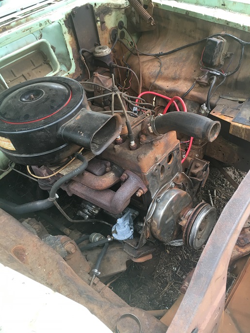

I have both and like both equally. '59 Dodge Coronet 4dr sedan thats getting a Plymouth OD transmission. Only Plymouth offered an OD trans for the '57-'59 Mopar 230 Flatheads
