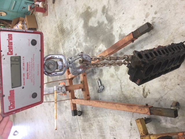

Do youself a favor. Borrow or rent a cherry picker/engine hoist and pull the head and manifolds as a unit. If all you are doing is fishing out a screw, you willbe time and money ahead by leaving the manifolds attached to the head.
 Post subject: Re: Slant Six Head
PostPosted: Sat Mar 28, 2020 4:16 pm
Posts: 1479
If the head is one of the newer ones, without the spark plug tubes, you are looking at about 80 pounds. An iron intake/exhaust assembly will be another 40 pounds. These are ball park figures. An early head, with the spark plug tubes will come in at around 67-70 pounds.

1968 head

Also you can use a pipe about the same diameter as the rocker shaft and bolt it to the rocker stands to use as a handle. The assembly with the manifolds attached would be very cumbersome to remove with 1 person.

FWIW, when my head seized a valve in the fresh guide, I pulled the head and manifolds off in one piece. I also reinstalled it all in one piece, so as to accommodate my inherent laziness. There's a point of balance where it all stays pretty flat in all the right directions. I seem to recall I used the two threaded holes on top of the head and chose the link of chain that gave the best result. But I did use a cherry picker hoist to lift it due to my already mentioned laziness and newly mentioned weakness.
