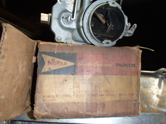

I was looking through my shelves and I saw this box. I didn't even know I had this. I saw an old man back in '06 driving and old dodge truck. I followed him to his house and we became friends. I bought my 1st Forward Look car from him. It was a 1960 4dr Plymouth Savoy with 17k actual miles. His wife wrecked it early in its life and he fixed it with a Fury front clip and never drove much after that. He only drove mopar. Years later I stopped by to see him( every couple months) and there was a dumpster by his shop. I knew it wasn't good. It was filled with shop manuals, parts, you name it. I found out they had already loaded 1 other dumpster. This carb was 1 in the dumpster. I ended up buying 4 more Mopars from the heirs. It looks like its been run but its clean and tight.
looks like a Carter BBS.
