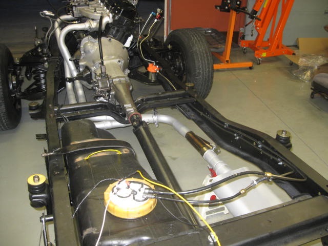

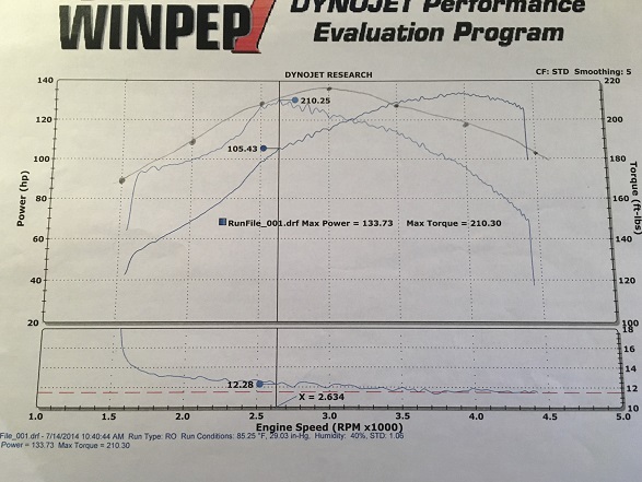

The engine in the 83 D150 is .030 over stock style Silvolite pistons, 8.5 static compression ratio, Holley 2280 2 bbl with water heat to the carb base and cold air induction, dual Dutras with 31 inch long extensions on them prior to joining in a Y, HEI ignition,
The cam is Oregon hydraulic 1333 intake on the intake side and Oregon Hydraulic 1527 intake on the exhaust side
212 Intake at .050
206 Exhaust at .050
.447 Intake lift at the valve
.432 Exhaust lift at the valve
on a 105 Lobe Separation Angle
a hydraulic cam similar to the mechanical Oregon 819 cam mentioned earlier
the 819 is
212 and 212 at .050
.448 lift at the valves
I had the D150 on a chassis dyno, a chart is shown below
133.7 HP at the wheel at 4000 RPM
210.2 Torque at the wheel at 2600 RPM
when accelerating you can feel the torque come on about 2200 rpm and the curve is fairly flat from 2500 to 2800 RPM that puts the good part of the torque curve
right in the range of highway driving RPM's I have 3:73 rear gears.
For the exhaust tone, I was particular on the exhaust routing, it exits on the side of the truck in front of the rear wheel.

File comment: Exhaust routing
File comment: Chassis Dyno, power at the rear wheels

~134HP (I rounded it off) at the wheels, what would you guess at the flywheel? 180? 200?
PostPosted: Mon Apr 20, 2020 8:24 pm
Posts: 14950
165ish. Drivetrain eats 15-18%.
