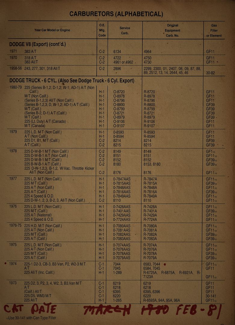

6537 heavy duty emissions ,7044 90 percent sure is also heavy duty emissions.https://www.slantsix.org/forum/viewtopi ... heavy+duty
PostPosted: Sun Apr 19, 2020 7:34 pm
Posts: 1603
7044 was after market service replacement for 6583, and also came standard same year for 225-1 slant six. Both carbs listed for D 100 200 300 manual tranny. There is work around for purge port.
Yes, the canister purge plumbing is handled as described here. But that's not the port I mentioned—I was talking about the (nonexistent) venturi vacuum tap for EGR. There is not really a workaround for that, except for simply not having EGR, which is a completely viable option.
BBS 7044 is not an aftermarket replacement carb, but it's no surprise if Chrysler supplied BBS 7044 ('74 Dodge truck 225/standard trans) as a service replacement for BBS 6583 ('74 Dodge van 225/standard trans).
BBD 6537 is 74-'76 Dodge truck 318/auto, non-California, heavy-duty emissions.

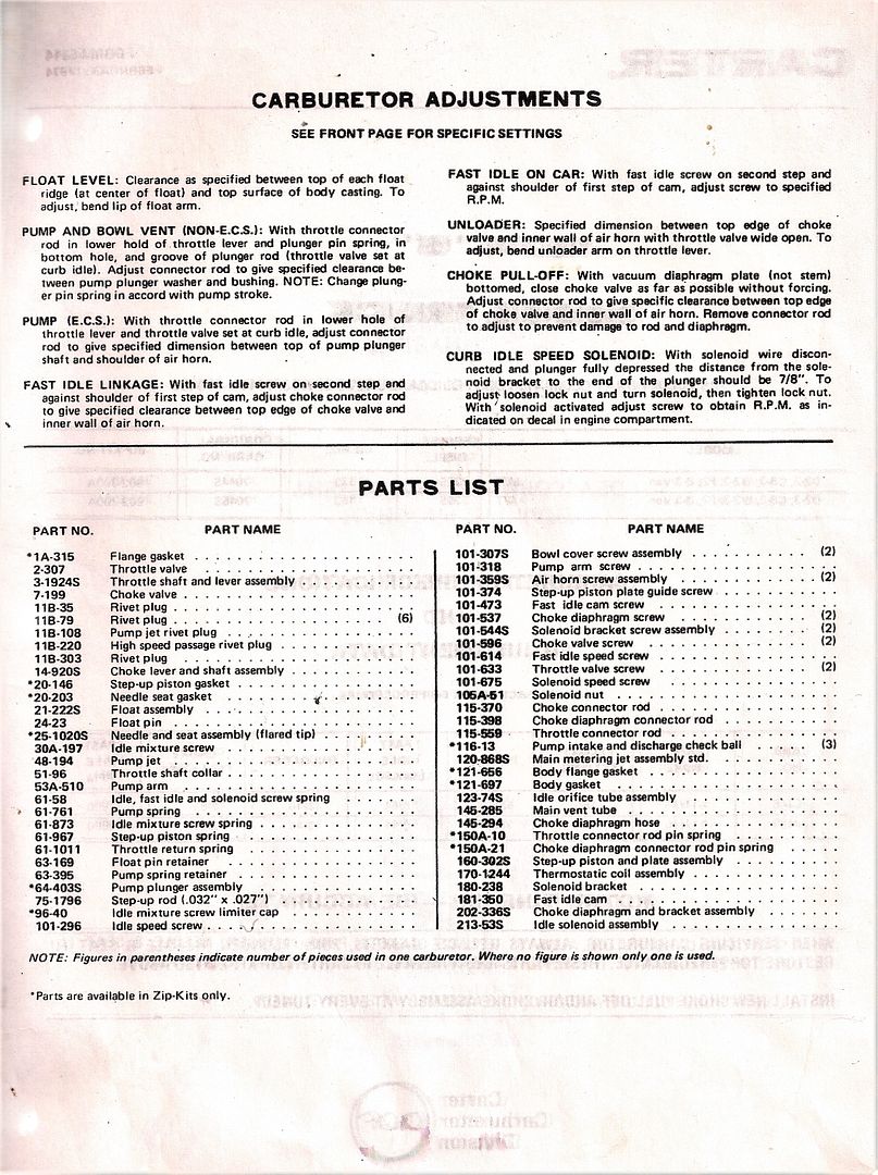

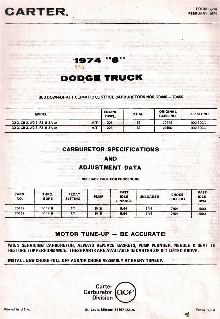

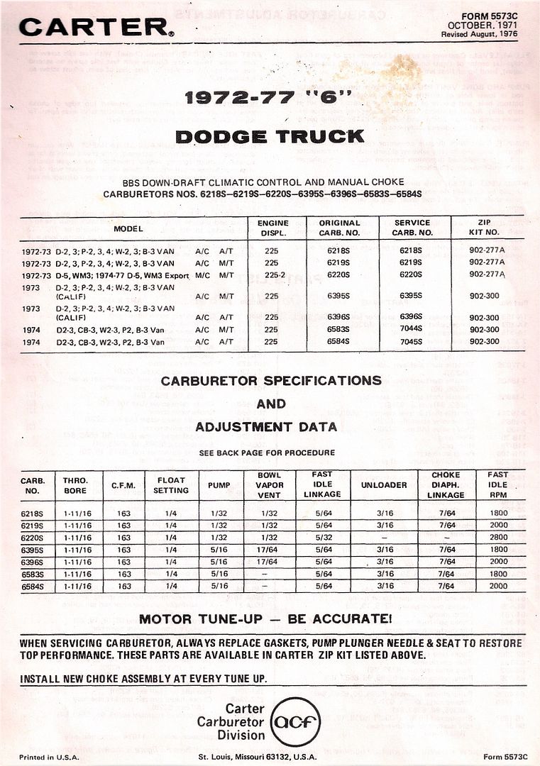

7044 listed as service carb and original equipment,mid year running production change?

"Install new choke assembly at every tune-up", LOLROFL
