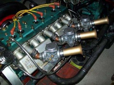

I can not add a whole lot here, as I have spent more time behind a flathead than I have a slant 6. My PERCEPTION is that a slant 6 will tolerate RPM with more ease. My 230 flathead is happy and bomb proof between idle and maybe 2700RPM. Yes it can be made to turn more RPM's but a slant 6 will live and thrive where the flathead tends to run out of breath.
I will agree the Slant 6 and the Flathead 6 are 2 different animals.
I.would agree they would perform optimally at 2200 to 2700 cruising speeds all day long. Some flathead 6 owners cruise at 3000 rpm on highway.
Stock they are rated at 3600 rpm, and will perform in the 3200 rpm band if needed.
Chrysler would routinely run these engines for 50 hours at 3600 rpm for tests during the production years
You want these engines to breath snd perform better, same stuff as slant 6 in theory.
Yes a flathead can be made to rev to 5500 rpm, would they run like that all day of course not. A 225 slant 6 would perform better than L head for sustained RPM perhaps, although a 225 has a 4 1/8 stroke and is an undersquare engine, so piston speed is a concern.
Flatheads can certainly be made to perform, to the degree of a slant 6, no as they certainly are a different movie.
The 265 has a 4.766 inch stroke and is rated as 228 Lb.Ft @1600 (according to my Motor's manual)
If you are want to keep up with traffic, and drive the truck at the fast pace of today, then a slant may be happier singing along at 3500 RPM
If you are wanting to cruse and loaf, and enjoy the truck at the speeds it was built for, then a flathead will serve very well. With an overdrive, and the 265, with some modifications, it may be very nice as long as you are not trying to spin the motor real hard.
