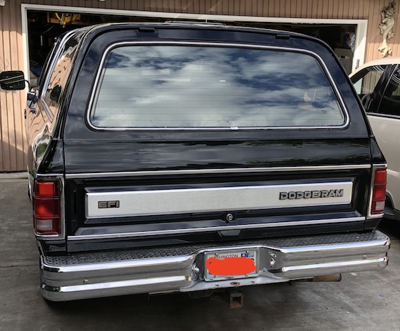

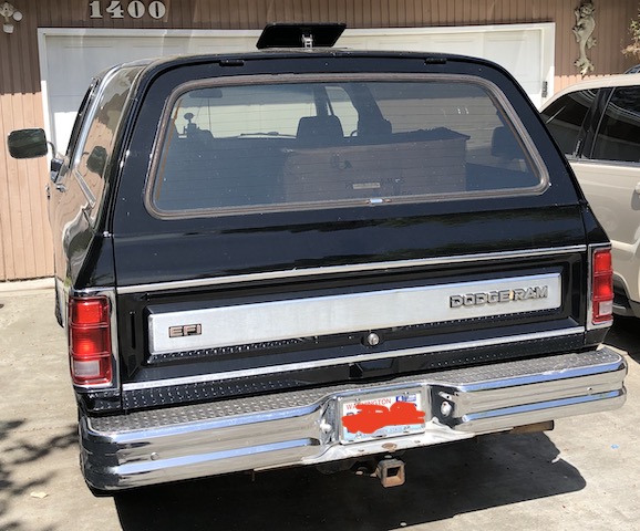

I was able to use the lockstrip tool I bought to fight the lockstrip into place. It looks much better than the faded old lockstrip.
I did discover the cause of my problems. AFTER installation, I compared the profiles of the old original lockstrip and the new lockstrip LMC truck sells as fitting D series trucks and Ramchargers. The LMC lockstrip is MUCH wider than stock. That is why it didn't fit the lockstrip tool. I should have checked BEFORE I installed it. But it is done and should be fine for years to come.
Learn from my mistakes! Verify all replacement parts are correct in all dimensions.
File comment: New lockstrip
File comment: Old lockstrip
