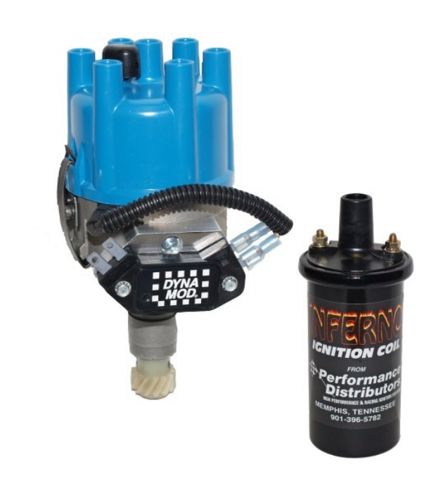

What is the procedure for timing a lean burn, no vacuum advance and what is the setting. So far when I set it at 12 degrees it has some pinging.
 Post subject: Re: Hello All
PostPosted: Wed May 27, 2020 8:49 am
Posts: 3283
single pickup or dual pickup within the distributor?
If you are doing the HEI, you will be deleting the lean burn anyways, in which case you'll be yanking that distributor and putting one from a slightly older model in, that has both centrifugal and vacuum advance of which the lean burn one does neither.
at that point it will be a "play with it til you get it to run the best" situation, where ever it winds up with the timing light.
also remember these engines had lots of issues with the outer ring on the damper slipping, making the timing marks non accurate.
to truly answer your question, to time a lean Burn setup, you yank it off, and do the conversion. Timing the flight in the air til it hits the garbage can, is optional.
Many do the HEI, of which I have yet to do, I just did my 85 and retrofitted it to a Mopar 4 pin ECU.

"to truly answer your question, to time a lean Burn setup, you yank it off, and do the conversion. Timing the flight in the air til it hits the garbage can, is optional."
I don't get it this distributor doesn't have the vacuum advance.

Thank you for that information! Through my research and conversion efforts with the HEI I found that some Holley 1945 didn't have the, no vacuum at idle, takeoff needed for the vacuum advance. My D150 with the dual lean burn is one of them. Do you know what the work around is for this?
PostPosted: Thu May 28, 2020 6:56 am
Posts: 3283
the workaround for that is a different carb from an earlier model. good time to do a super 6 swap it you ever considered it...
on the distributor, you'd be better with a factory one from an older model than the one you pictured, too.
