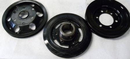

There seems to be a difference of opinion here. Does anyone have pictures of both pulleys off the damper?
Thank you
PostPosted: Fri Jun 19, 2020 6:21 am
No, the front pulley for the PS is different then the rear pulley for the A/C
This is 100% correct. The rear pulley has a centering hole large enough to fit over the damper hub, the front pulley only has a hole large enough to fit
a crank bolt through the center if you desire to have one... if you have the damper off the motor it will become very clear.
