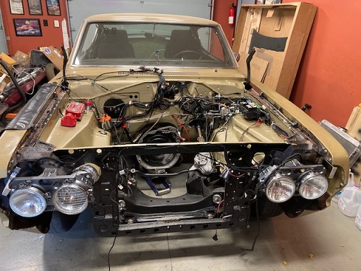

Posts: 3857
pulled one motor out and put a better motor in,, a good day
