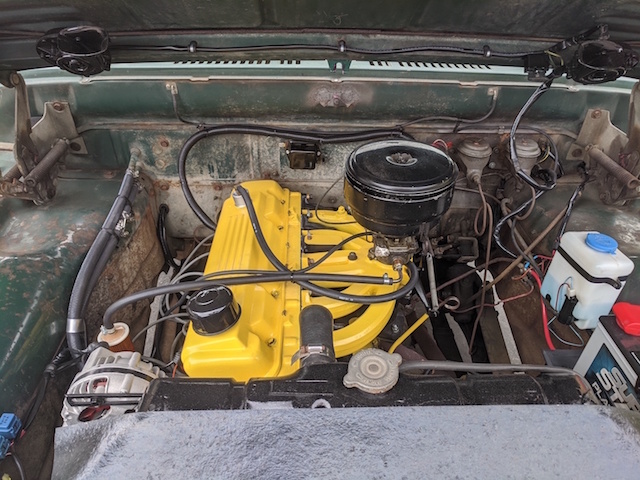

So the great lapse in responding was all of the engine work that I did. I think that I spent way too much time painting, haha.
It is running great now! Attached is how it looks. Off to the far left are the headlight relays, thanks for the pre-made harness SlantSixDan.
Cheers, Bill.
Smoke em if you got em.
PostPosted: Sat Jun 20, 2020 5:41 pm
Yellow engines run better. Scientific fact! :mrgreen:
PostPosted: Sat Jun 20, 2020 7:08 pm
looks great, does that truck have two firewall mounted master cylinders?
PostPosted: Sat Jun 20, 2020 8:57 pm
One for the brakes…one for the clutch.
