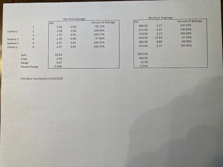

I received the injectors and test data back from Will. Thanks Lou, that was a good tip.
Will was great to work with. This forum has superb support.
It appears that the injectors are fine, although the #6 injector was the richest in the group.
Below is a table with averages and percent of average.
At idle the injectors were all within 3.4% of the average
At full open the injectors were within 4.8% of the average
No test data to support this, but it seems that cylinders 1 and 6 would tend to get less air flow due to the longer intake path,
and cylinders 3 and 4 would breath the easiest, due to the short runners.
I will put the injectors that flow the most in cylinders 3 and 4 and the ones that flow the least in 1 and 6.
PostPosted: Fri Jun 26, 2020 9:09 am
Posts: 17678
Hi Dadtruck,
Thanks for the data - very helpful. Note that cylinder 1 usually runs hotter, and so it might be good (if pushing the engine hard) to add fuel there. If it were me, I would probably put a higher flow injector in #1 cylinder. I have noticed, especially after road race events or in a car where I do more of those things, that #1 rockers/valves have more wear. If detonation is going to happen, my guess is it happens more in #1. I cannot recall if I have seen more plug speckling (boiled aluminum) on #1, but I feel like I have.
For economy, I imagine you might want less fuel to #1 to give the best mixture matching, but I need to think about that further...
