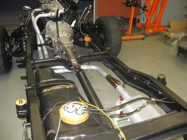

there are three foot long extensions after the Dual Dutra's. That then Y in together.
I have been told the exhaust has a snarl to it. The motor was not built / cam'd for RPM
The exhaust tone comes on in the mid 2000's RPM

Interested to learn about this exhaust design. I am guessing you built it that way for torque-or low RPM response?
PostPosted: Sun Jun 28, 2020 9:48 am
Posts: 3857
different sound to it than any other /6
Exactly, for the exhaust I was most interested in scavenging.
The down pipes are not large, 2 1/4 to keep velocity up. After the Y it goes to 2 1/2
I normally have the D150 on the road this time of year, it’s a summer time daily driver. With the stay-at-home this year I have not got it out, or I would get you a sound bite.
I can say it is not nearly as rumbly and as deep as the note in the video. A snarl is a good description, maybe more like a Maserati or a Jaguar.
I have a Flowmaster 60 for a muffler. I had to move up from a FM 40 as it was too loud. If I was to build this today I would likely use a DynoMax muffler.
A portion of the exhaust tone is also due to cam lob timing.
I did something unusual on the cam grind. It was ground with the exhaust center line at 105, that opens the exhaust valve early. Normally exhaust center lines are 110+. Again I was after exhaust velocity and emptying the cylinder to help fill when the intake opens.
I've seen a cut-away drawing of the 300 SL in the above, it also has a two long down tubes and what I assume is a straight through muffler.
DadTruck, your cam was ground with an early opening exhaust, to help completely empty the cylinder. The desired end result being a cylinder that is devoid of leftover combustion gasses? ( I am guessing it is a nuanced and low RPM variation on the somewhat common idea of having a narrow lobe separation angle for mid range-top end charge) So your intake lobe is of close to normal interms of duration and intake opening/closing, but the Exhaust opens early to give a yank on the intake gasses.
Have I got the general idea?
Would love to hear it, when and if you get the truck out this summer. My Slant 6 is presently stock, and will be until I show myself that I have successfully installed it in the M37.. I've got the motor mounts done, and presently working on the clutch release system.. hopeful to have some workable idea on that front by the end of today.
yes the intake is on a 105 centerline, and then I advanced the cam a couple of degrees at the install.
and yes the goal was to clear out the cylinder with a lot of exhaust velocity at low to mid RPM's.
Did it work, well I think so, the truck pulls strong starting in the low 2000 RPMs, but I have no back to back data:
same engine, same vehicle, different cam. I wanted to try an idea and I did.
I picked up a small NOS Mopar Performance slant cam and I plan to install that eventually, just to see, hear the difference.
I may get to that this year,,,,,
