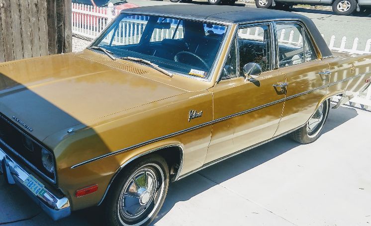

hi , i have a 72 valiant with a slant 6 225. i did the hei upgrade , rebuilt carb but idle still needs to be pretty high to keep from stalling,and it really wants to go or die. according to original owner it always did this. in my younger days i loved my 3200 stall converter. it seems like if this had one it would be more driveable. maybe not so much as a 3200 but anything to help it slip more at idle. any suggestions?

That hei upgrade really helped with the stalling , starting and overall running. yes I did adjust valves and set timing. I rebuilt the holly 1920 with usa parts from Mike's carburetor. I got the idle lower today but ready to bring this car to a friend mechanic for the final tune..I would love to bolt on a new carb but can't pay 400 for a 1920 holly, doesn't seem right. I did see new chinese copy cat holly carb that is for a ford ,was wondering if I could swap linkage over to it and go? I'd hate to run communist carb but anything to get her right...O and still haven't done a compression test but only has 87k on it . I'll get to it soon
