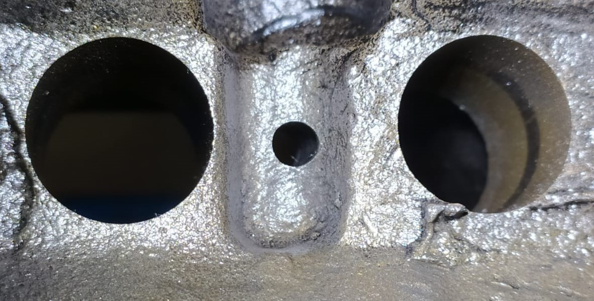

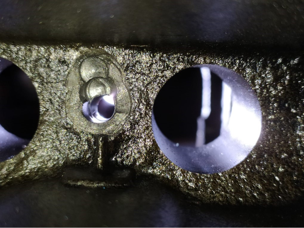

PostPosted: Sun Aug 30, 2020 9:23 am
Joined: Mon May 20, 2019 2:22 pm
Posts: 25
Location: Poland, Krakow
Car Model: 73 Dodge Dart Sport 198
Thanks Gents, here are some photos of what I did. Although, I can't see a hole in the drilled shaft, no air bobbles through the hole either to the jacket either, can you please ensure me I am good to go? Or need to bolt it anyway? My concern is that during drilling I felt milder material so I might be v. close to water jacket and under high temp a leak can develop...

PostPosted: Sun Aug 30, 2020 11:45 am
Posts: 3740
Location: Sonoma, Calif.
Looks like the new hole is located OK but you never really know what-is-where with sand castings...
Play it safe by tapping out the hole and fitting a plug that can later be added / removed from the top, with the valve cover off.
Then decide if you want to start the engine with the plug in... or out. :?
