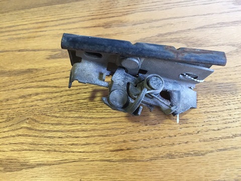

I talked with Charlie S, he gave me a verbal description and then I found a photo on the internet,
the torsion spring on my latch has gone AWOL,, I'll find a suitable replacement.

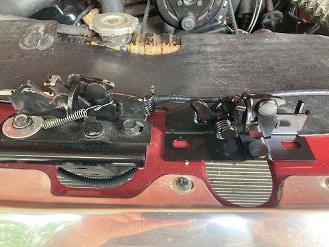

The new latch from LMC arrived. In the photo the OE latch still installed with my temporary spring is on the left, the new LMC latch is on the right.
Did a visual comparison, the re-popped latch sure looks identical to the OE part, metal thickness the same, rivets the same...
I am sure that if I could buy a replacement 1983 D150 hood latch across the service counter at my local Ram dealer, it would be more than $29.00
Installed the new latch and it works fine.
