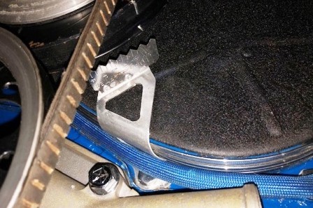

My 79 engine has three marks on the balancer. I made my own pointer to align with one of the marks so that I could set the timing from the passenger side (alternator is mounted on the driver side and blocks the view of the 'usual' timing mark).

Geeze, Matt, that's really nice work! Looks as good as a high-endy factory piece. Can you walk us through how you made it (marks, stampings, finish, etc)?

In the 80s, on vans there were factory second timing tabs (I can confirm for the V-8 engines, I can't speak for the slant) that were read from below. The noses on the vans were so short and the belt drive system and radiator fan shroud so obscuring that it is physically impossible to read to stock timing tab marks on the timing cover. The solution was a second timing tab that bolted to the timing cover (maybe the oil pan bolts) that was read from below. Matt's timing tab looks very similar to the factory V-8 piece.
