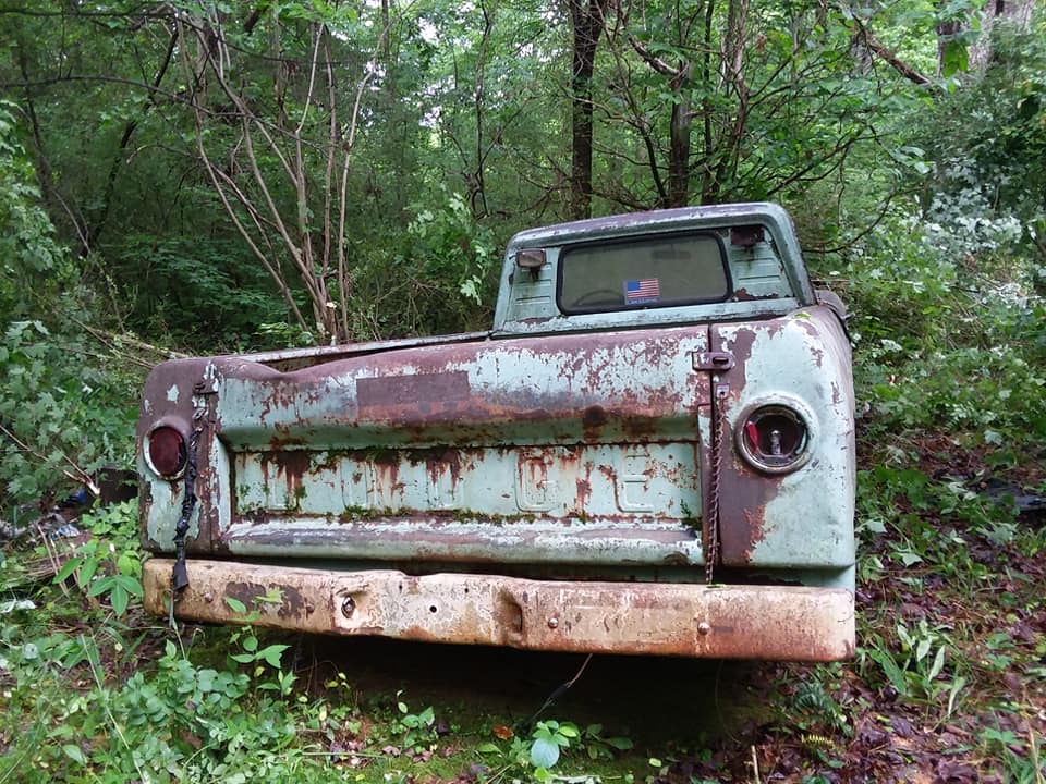

This is it the day I pulled it out of the woods.
