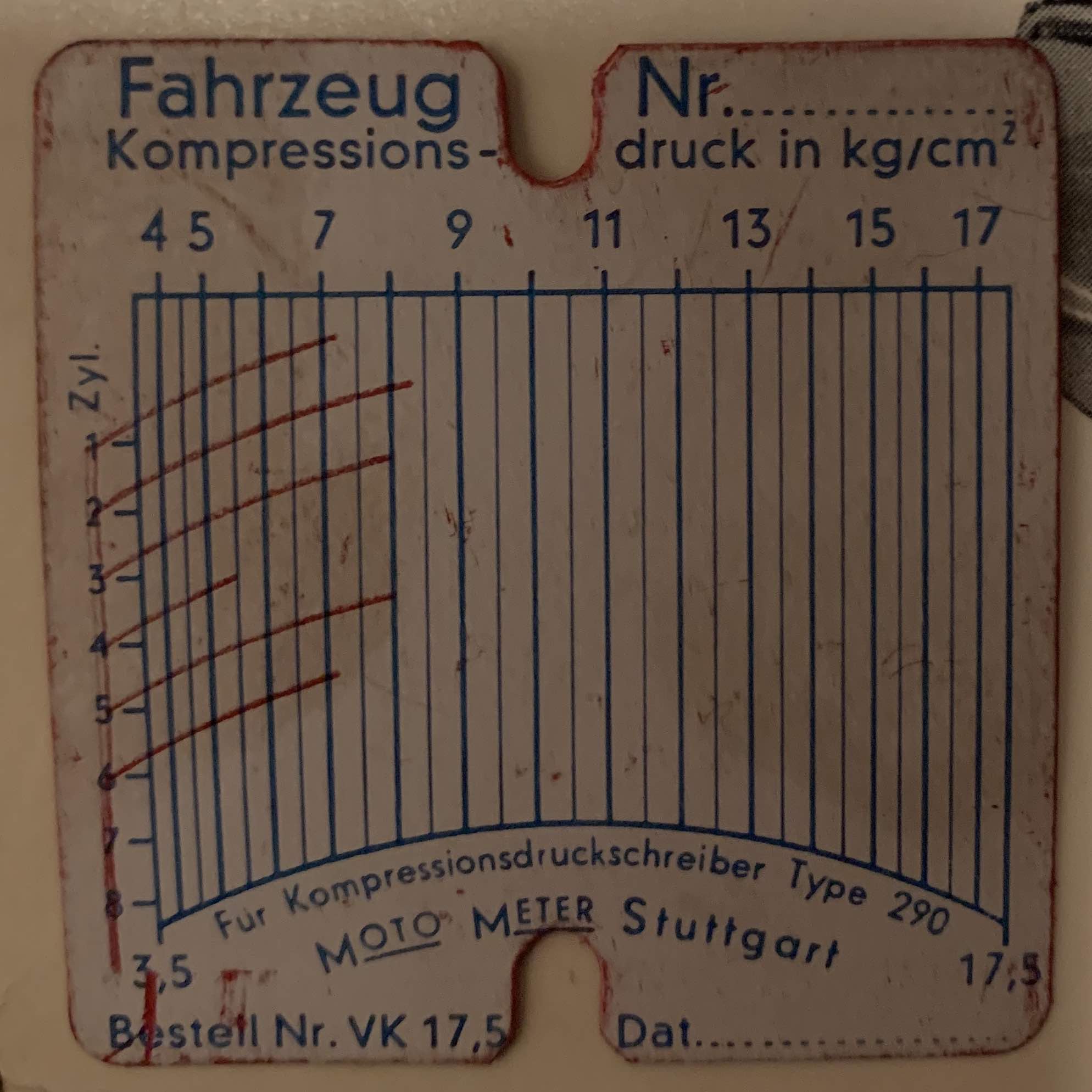

I'm in love with this beauty, but just found out that there are some serious motor problems (almost no compression on cyl. 3,4 and 6).

Hello and welcome! Before you get too worried about no compression, check the valve lash. If the clearances are too small the cylinders won't build pressure.

Welcome! Before doing anything else to the engine, please adjust the valve lash (clearance). That can cause low compression and the adjustment is almost free.

Yesterday i was adjusting the valve lash, now the slant is running much smoother than before. I will now check the compression again...

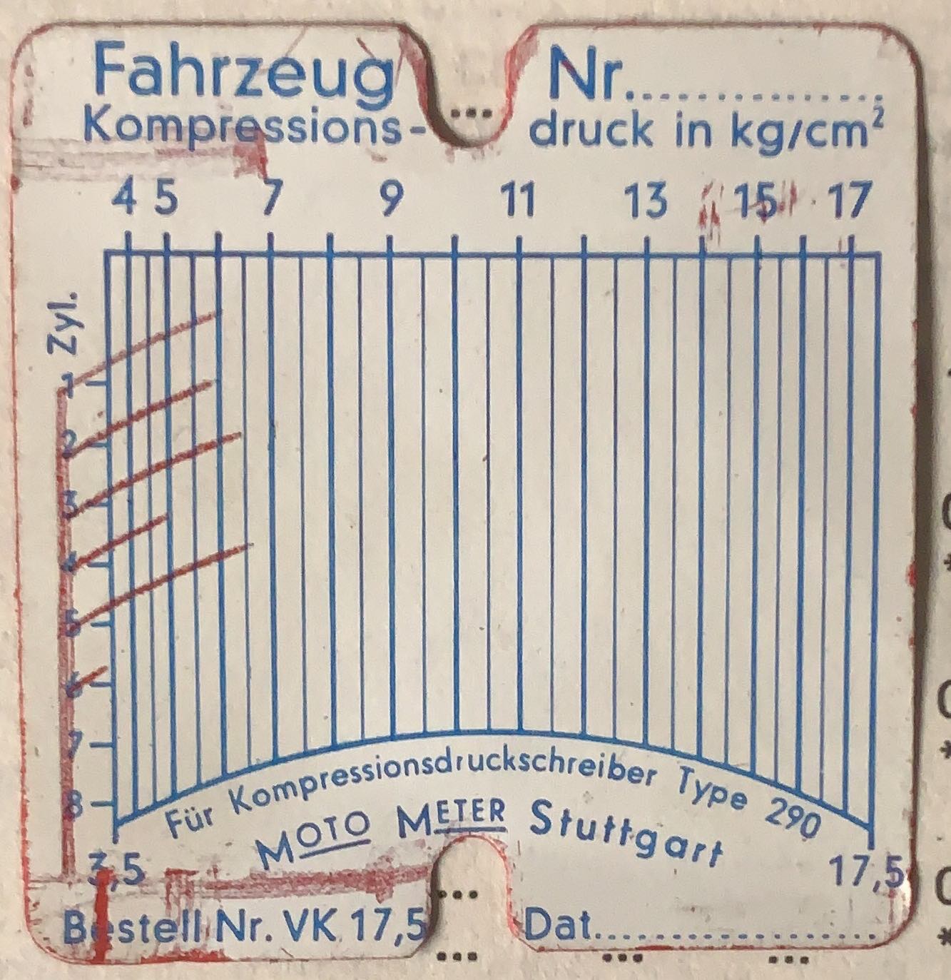

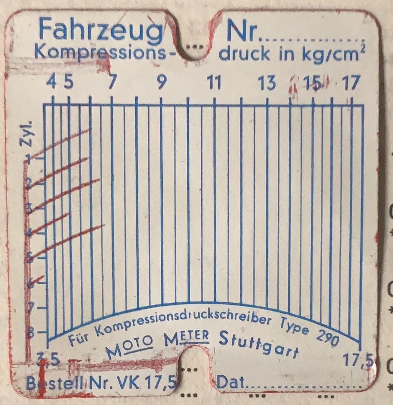

Here's a little update about my motor.
The compression test after checking the valve lash was not that satisfying, so i had no other choice than remove the cylinder head.
I saw, that not a long time ago, someone else replaced the head gasket and the valves . But the valve seats didn't look that great. If I had replaced the valves by myself, i would have replaced the seats too.
So i did my best and grinded the valves and seats with professional tools.
You can see in the picture down below what came out: First measuring, after setting the valve lash, and after my work with the valves.
In near future I will replace the valve seats. If you have any recommendations where to buy the parts (Valves, seats, stem seals etc.) which can be shipped to Europe, I would be thankful for that.
