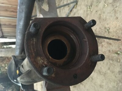

When I pulled out the half shafts there was no seal and no gasket.
I assume there is supposed to be a seal and gasket!?!?!?
The shaft looks like there was once a seal running on it.
But there was no leaks!
The bearing has an outside diameter of 2.675 inches.
Does anyone know if this is the small, medium or large bearings.
I have no idea if this is the original or a replacement axle.
Does anyone know the correct seal.
I am definitely running the small lug nut pattern and 9 inch drums.
Thanks
