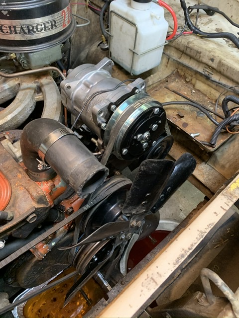

PostPosted: Fri Sep 25, 2020 2:44 pm
It is a 1966 Dart with stock 225.
Then yep, the P/S pulley and pump bracket is different with vs. without A/C. The "with A/C" pulley is dished so as to move the belt groove forward, toward the radiator. The "without A/C" pulley is flatter. The brackets place the pump appropriately in accord with the pulley.
I modified the original Compressor bracket from a 1966 Plymouth Valiant slant 6 And mounted a Sanden compressor.
Cool! Can you show us pics?
As I mentioned I aligned it with the rear most pulley.
That is correct no matter with or without P/S.

File comment: Hope this loads ok. I don’t have a good pic of the bracket mods, but basically I cut the top off to make it wider in the opening at the top and then straightened it out to match the belt alignment.
