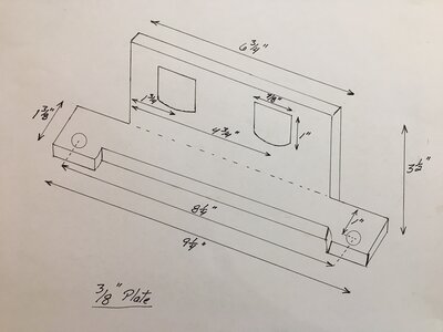

Here is a drawing of mine with measurements. Mine had two holes in it. One for the engine only and one for the engine and transmission. Mine came "factory" on the 1980 airport tug I bought. I'll post a good photo for you later.
Mine was 3/8" plate which is probably overkill?

Hey Greg. That's a beefy lifting bracket! I'm thinking you take the transmission out with the engine, and you get some tilt towards the tranny. Is that accurate? Rick's diagram shows a lifting point toward the front attachment bolt to balance the engine more, which is my application.
Rick, I am starting to work on the steel I bought and I think I am going to take the valve cover off and make the head attachment holes more centered. On your diagram do you have room to put the chain side towards the valve cover or towards the carb? Thanks again guys.

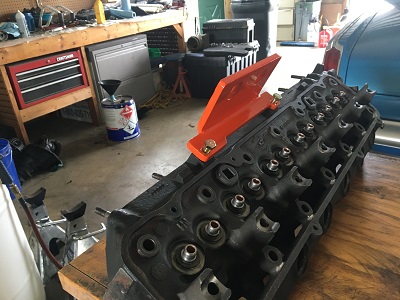

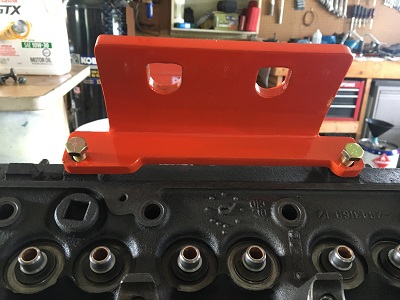

Not sure what your asking? My bracket allows you to lift the engine with the valve cover on. Hope these pictures help.
