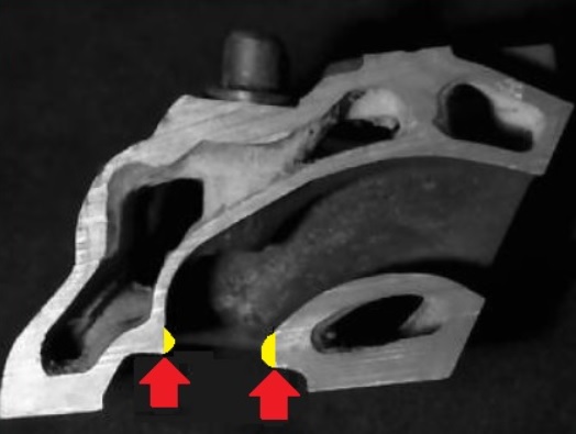

It's a 1971 head. I'm planning to get seats, bronze guides, and 1.72"/1.45" valves. I asked my machinist to perform the chamber/port work under "Cleaning Up the Imperfections" in Doug's book (p.96). If clearance is needed for a higher-lift cam, I'll ask him to do the stuff under "Grinding the Valve Guide and Seat" (pp. 97-98). This car isn't for racing, and it won't have fat tires, but I'd like to get... I dunno... 0.85hp/ci for all the trouble? I expect the roadster to weigh 2000lbs or less.

Head work per Doug's book ("Cleaning Up the Imperfections" and the intake port work shown in the photo)
