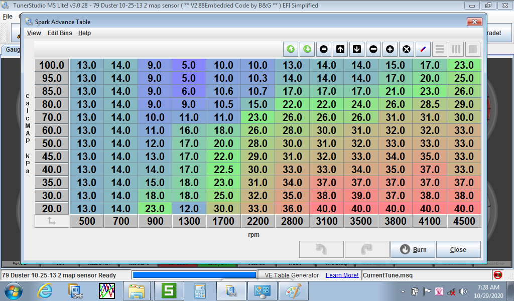

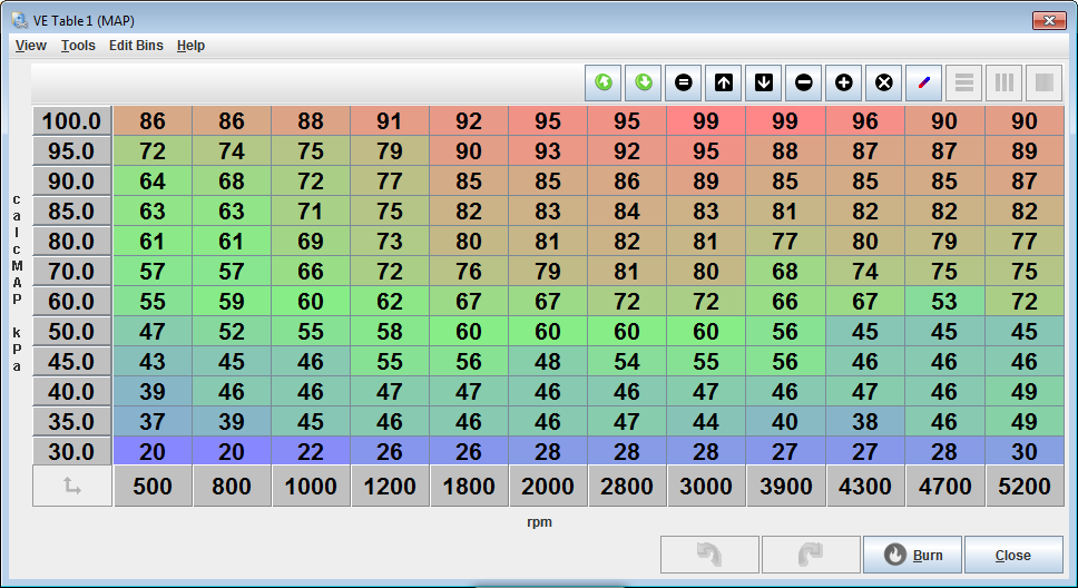

PostPosted: Thu Oct 29, 2020 8:13 am
Posts: 10438
I am not sure how helpful these will be as I believe the maps are for each specific build / type flow rating of the injectors ... if nothing else it will be a nice picture of numbers.
Here is a file too. for what it's worth.

PostPosted: Mon Nov 02, 2020 5:02 am
Posts: 483
Location: Lawrenceville, GA
Car Model: 1966 Dodge Dart
The VE tables are designed to be independent of the injector size - the ideas is to have the injector data elsewhere, so if you swap injectors the only thing you have to tune is injector data itself.
I sent Frank a copy of my tune as well, but it is a very rough tune as the tuning got cut short when I lost a rod bearing.
