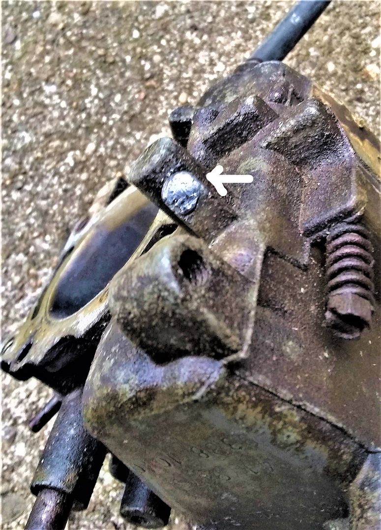

Another way to seal that hole is the way why Holley did it originally with a Lead ball Image

Image Ridge line

file plug flat, center punch use 1/8 or number 28 drill bit. Real easy do not go too deep. When done tap ball with small hammer.
