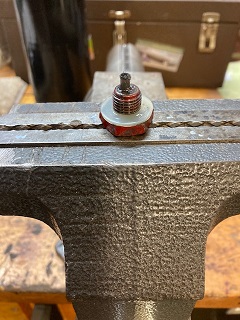

This is something that I do on all my vehicles, add to the engine and transmission drain plugs.
Rod magnets are cheap,, drill a close fitting hole into the drain plug, add a drop of high temperature epoxy, insert the magnet.
You may find a small 'furry hat' at the magnet tip when the drain plug is removed for service,, if it ever is a lot bigger, you know something changed, or needs to change.
https://www.amazingmagnets.com/t-neodym ... gLBPPD_BwE.
