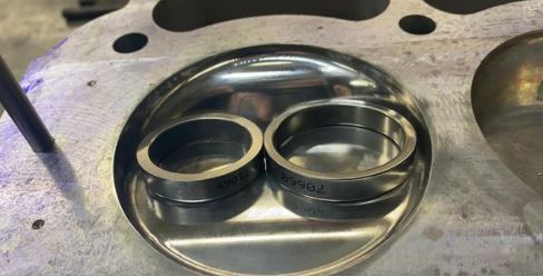

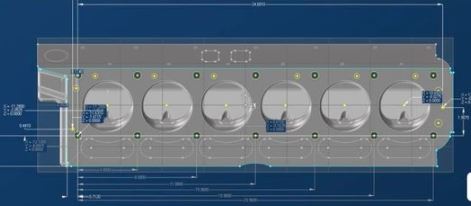

I will snip some pictures of Robert's work and post in a minute.
PostPosted: Thu Dec 31, 2020 7:49 am
Posts: 2747
Robert's head pictures.
PostPosted: Thu Dec 31, 2020 3:37 pm
I don't think making a head is that tough...it's a lot of machining but not tough.
Except for one thing....water jackets. Those are internal while the rest of the head is external. So the challenge in making a head, or welding up an adapted head, is getting the water jackets to not leak and to be properly placed. The beauty of casting is it allows you to make internal passages.
So will his head fit? Yes. Will it run? Yes. Will it run for hours and hours with no cooling issues? That's the $64,000 question.
