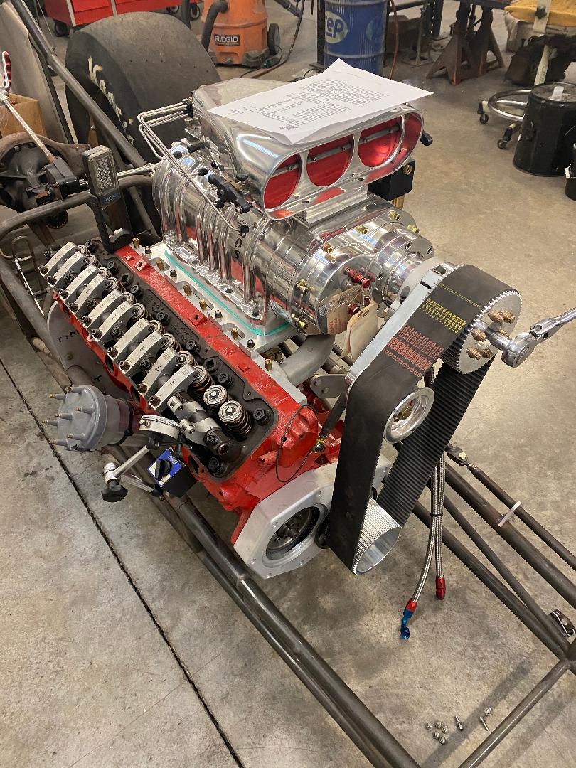

We didn't make that much progress. I got up there today, and we degree'd the cam in. A very easy processes with the Keith Black gear drive. Pull the pumps, pull the gear cover, remove the cam gear bolts, Turn the engine to the desired position, rotate the cam to the desired lift per the dial indicator. Install the gear where the bolts line up. Voila. Done!
Reinstall the cover, bolt up the pumps, and there we go.
Gary is going to work on getting the transmission reinstalled tomorrow, then will call Friday to verify I can get back up Saturday for some setup.

 Post subject: Re:A teaser photo
PostPosted: Thu Dec 31, 2020 12:17 pm
Site Admin
Posts: 7468
Location: Oregon
File comment: The setup for setting the cam timing.
Part of Tyrde-Browne Racing

Yessir,
Gary made the timing cover, as well as the blower intake. I ought to see if he has a set of drawings for them. It's billet aluminum, He made it from a solid aluminum plate I sourced on his Bridgeport Mill. It's a manual machine. DRO's and power feeds of course, but no CNC capability. If he has a set of drawings, I'll see about getting copy(s).
We started with a Clifford short ram intake, cut, milled and welded it into what we needed, then made a custom plate for the blower. It has a slanted floor to feed back to the plenum opening. Not the most efficient design, as the blower moves air to the front drive end, but the blower would have to sit back over the firewall otherwise..
CJ
