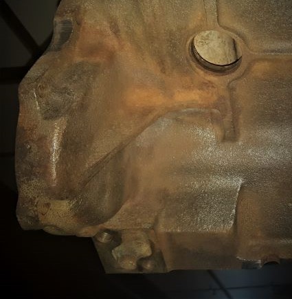

I don't think that's accurate. Here's a picture of my cast crank block and the water pump pocket reinforcement is of the same tapered style as the forged crank engine Doc pictured. Sorry about the picture quality, but I'm still cleaning the block.

After reading that same description I used to wonder about that too. It helped me to think up and down thickness instead of side to side width.
The web on a forged crank block gets thicker and wider on the block end. The same web on a cast crank block gets wider but stays the same thickness.

Sure. I still think the casting number is easier to see.

All these years I read that article to mean the thickness of the "gusset" as actually the width. Now that it's been pointed out I can see the more subtle increase in thickness of the rib...
