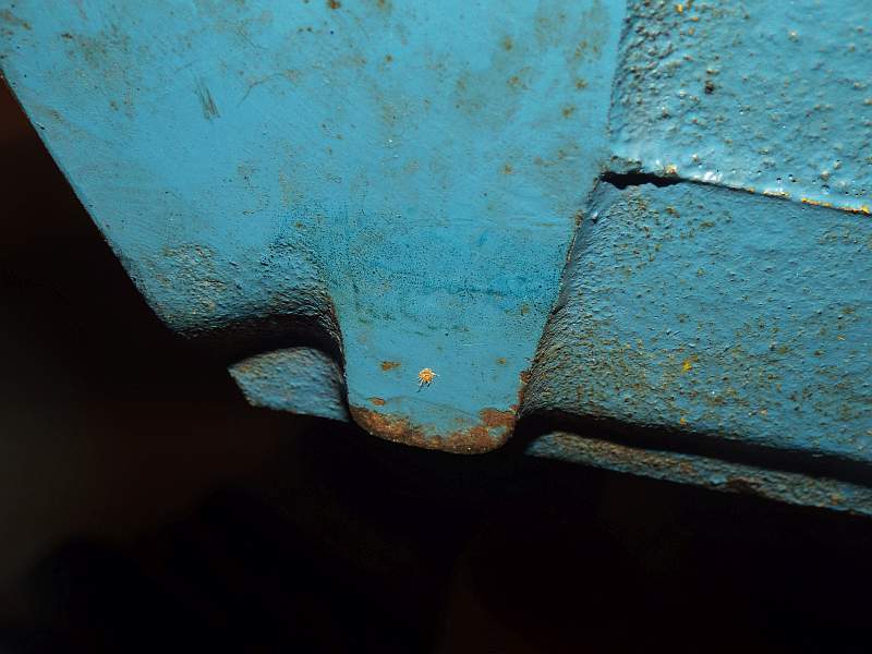

Now, this mark could be interesting. It's a blue ink stamping. I cannot make out what it says, even with a magnifying glass. It appears to begin with an "A" but that's about all I can tell. It is about as long a an "AAWJ"stamp would be, but I cannot see them both casting and stamping THAT, so I think it's something different.

PostPosted: Sun Feb 14, 2021 5:28 pm
The 'Blue Stamp'
Play with the photo in a photo editor.
You may find a setting that brings it out so you can see what it is.
And strangely enough, sometimes going out of focus helps.........

Gosh, I'm just "not that smart". lol Maybe one of yall can mess around with it. I don't really have a program that'll do that. I messed with photoshop in an older computer years ago and it blew my mind. lol

I messed around with it using the photo edit feature on my iPhone; I just changed the saturation, contrast, definition, stuff like that.
The result ws pretty amazing:
I never could get the "A" that you mentioned to become apparent to me, but I wasn't expecting this either!

Maybe I'm blind but I still can't tell what it says. lol
It may be a stretch, but I can see what looks like a "CC" in the pic.
Here's my original edit and a highlighted copy.
After seeing this, the "CC" mark stands out, for me anyway, in your original unedited pic.

Very interesting. I wonder if a black light would help expose something? I believe I'll try one before it goes to the machine shop.
I really appreciate your efforts!
