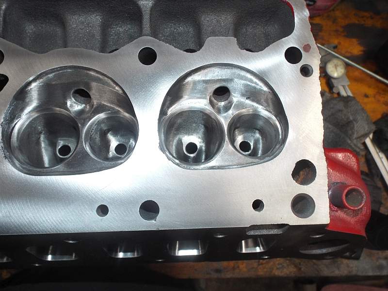

Got the head back today. Jerry did an awesome job on it.

Rob, can you post the flow numbers? I would like to see the whole range, not just the big lift numbers.
Thanks.
PostPosted: Thu Apr 01, 2021 5:04 pm
Posts: 136
Thanks.
Sure. I was just coming back to do that. The first sheet is after and the second is before. Keep in mind, these numbers are without any back cuts on the valves at all. Just a single 45. Also this is without the valve seats retouched. Both of which will add a bit more flow, once I get that done. Jerry said this head was the hardest iron head he's ever seen. Said it has a very high nickle content because it was constantly showering sparks the entire time. This is the last iron head he said he'll ever do.

PostPosted: Thu Apr 01, 2021 6:03 pm
Posts: 3298
Probably said out of frustration. Surprised at the single angle valve job, everyone and their brother who has ever done head work says at least a 3 angle valve job is essential with some telling you that you gotta go 5 angle.
If that head is so hard, that much nickel content, (almost) sounds like stainless.
Being as how that head is so hard, I doubt you'd need to add hardened seats then.
The ones that I have been messing with had minimal sparks when grinding, and the material peeled away alot faster than I would have expected.
PostPosted: Thu Apr 01, 2021 6:29 pm
Posts: 136
I'll never add hardened seats to anything as light as this Valiant or anything that doesn't spend the majority of it's life towing or hauling heavy loads. They are much less important than people think.
Oh and it has about ten angles on the seats. Was done with an almost new rottler. That will get touched up in a few days along with the valves getting a 30 and 15 added to smooth out the transition.
PostPosted: Fri Apr 02, 2021 7:52 am
Posts: 136
I don't know.....I don't think that it was frustration. I think it was "tired of cast iron". I asked him about doing another slant six head for me over a year ago. He said then he wasn't doing cast iron anymore, but that since he had done one for me in the past and like them because they were something different, he'd do another one when I was ready. I've been keeping in touch with him ever since....he is a friend too after all. Then I came across the closed chamber head. I was just going to take him one of my nicer stock cores, but since I got this one, I took it instead and it turned out really nice. This is going to be a cool build with the closed chamber and solid roller cam.
PostPosted: Sat Apr 03, 2021 5:51 am
It's interesting that the exhaust side is a more responsive port than the intake. On the intake, it's pretty much all done by .400 lift.
