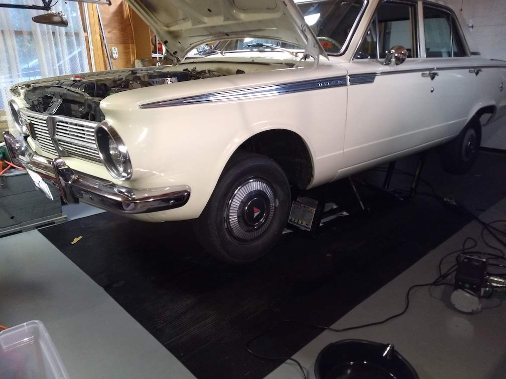

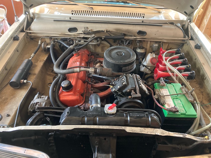

Thought with all this talk I should share some "eye candy"
File comment: On the lift

File comment: Engine Bay

Nice car! Good choice on the Interstate battery; I like NAPA-brand AGMs but those are good too. I like the ridiculous air horns. Plan on a dual-reservoir master cylinder conversion at some point, better yet with front discs. Scarebird offers a kit for small-bolt-pattern front discs; you just have to buy redrilled Chevy rotors from them or find a local shop to redrill parts store rotors. Late Mopar factory discs are better but require a change to large bolt pattern.
I wouldn't sweat the build quality on an Offenhauser or even Clifford intake manifold. It's a pretty simple device at the end of the day, and you can use a 2-to-4 barrel adapter on any of them. Acquiring a second cylinder head for the machine work is an excellent suggestion to reduce downtime. If you were anywhere near Houston I'd give you one I pulled off a parts motor for a 6-pack of Shiner.

Thanks! Yeah I needed a new battery after my Napa battery gave up after 10yrs. I got the Interstate Batt at-cost from my mechanic, we have a good relationship of I do work for him and he does work for me.
The Air horns I get all sorts of looks with them... And when I set them off going down the road, everyone looks for the General Lee! I do need to do a brake upgrade of some kind somewhere in this, still running 9" Factory front drums and re-po ones in the back. I wouldn't mind converting to the larger bolt pattern cause I have adapters on there right now for the ability to run those larger wheels.
I do think the Offenhauser would fit better than the Aussie because of my A/C compressor... The water jacket in the Clifford intake for some reason always turned me off... I do agree with the adapter thing, that's what I always liked about all of them! I do wish I lived closer to Houston I would totally take you up on that.
