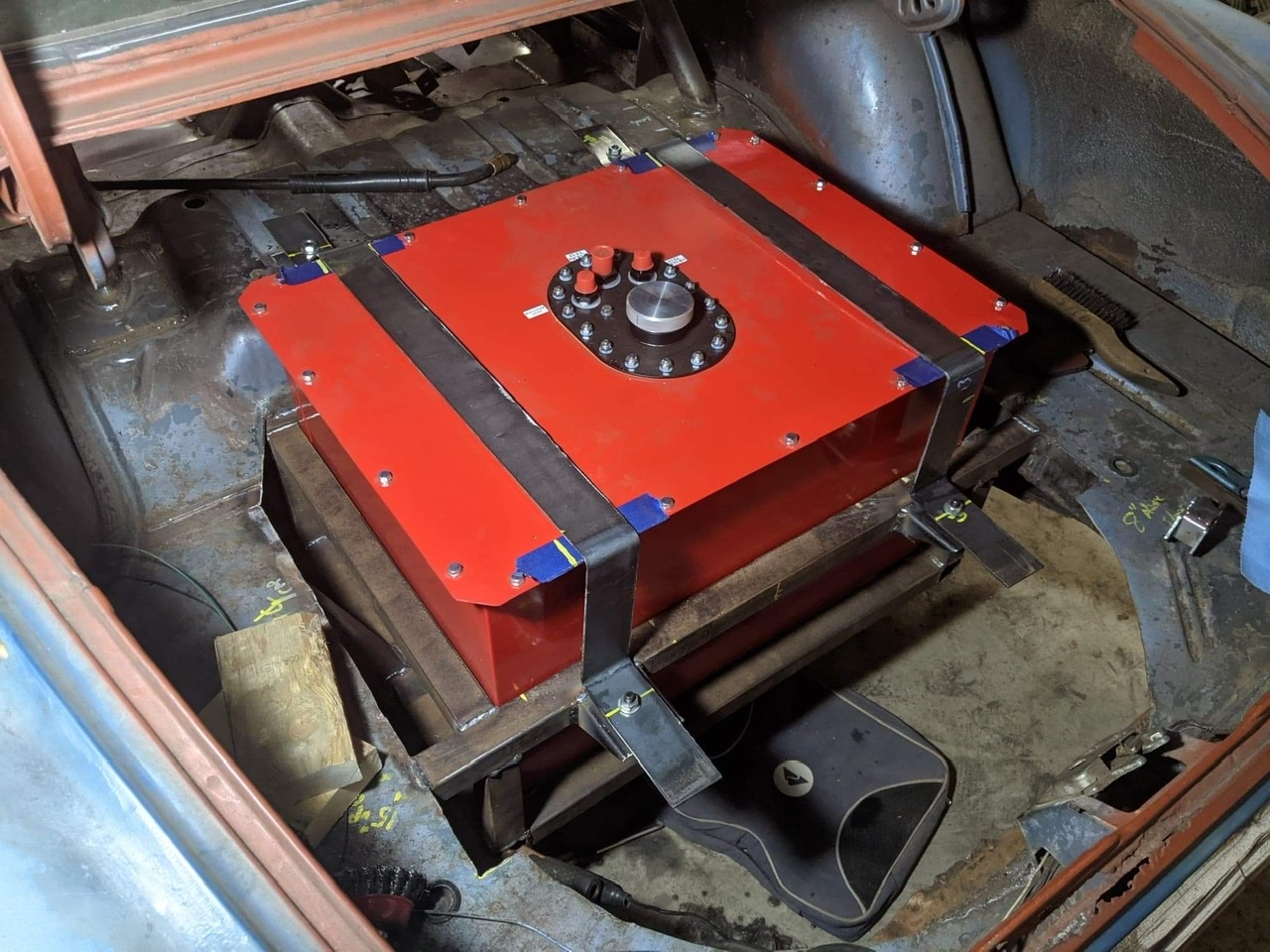

Adam has been hard at work finishing up the floors and installing the fuel cell in ToadRacer.
We will make a hard push at getting things buttoned up over the next month in an effort to be ready for the Lemons race in Sebring, FL 8-9 May.

Very productive day on ToadRacer yesterday.
Shifter, master cylinder, brake proportioning valve all mounted.
Verified some things on the racing harness mounting.
K frame notch completed.
Holes covered in rear bulkhead.
Anti-slosh foam added to fuel cell.
Fuel cell cage mostly painted.
Several other little things I'm forgetting.
