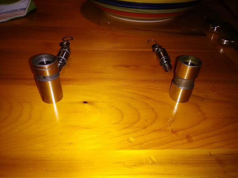

I don't know how many readers really understand how a hydraulic lifter works. The amount of oil pressure to the lifter really not important. the oil supply to the lifter is just to make up for "leakage". If the lifter is full of oil, and there is no leakage, no additional oil is necessary. Of course, there is always some leakage, so some replacement oil is required, but pressure requirements are minimal. Most engines with hydro lifters oil from the oil galley, to the side of the lifter. Then oil the valve train thru the pushrod (major leakage), so a fair amount of "volume" is required, at enough pressure to force the oil up to the valve train. Since the slant oils from the pushrod down, the oil requirements are much less. I don't know if any one has ever measured the oil pressure at the top of the lifter, but I would bet it is only 1 or 2 psi. The oil in the lifter does not raise the internal plunger (spring does that), the oil cannot be compressed, and in effect makes the lifter solid. Did I get that clear as mud?

I've never held a hydro-slanty lifter in My hands, & would've torn it down if I had, so I can't state how they feed&bleed compared to traditional ones. What I can offer is that the oil gallery, & matching lifter "waist/feed-hole" are higher on the lifter body for the Big-blocks, My advice is to get one of each & trial fit/cycle them to see how they play in the Slanty. Also as an aside, I believe the SB Ford link-bars are an accetable length for the Slanty, may take a little custom work for clearance..have never tried them so going by dimension only. Peace..

The Buick lifter doesn't have an oil metering valve as oil only needs to be admitted to the lifter body rather than fed to the top end. If oil pressure from the pushrod were high enough to unseat a metering valve then a conventional Chrysler/AMC replacement lifter probably would work in a 225. What would not work is a lifter lacking an oil passage between the pushrod seat and the main chamber. This would include most OE Chrysler lifters for V8s with shaft rockers oiled through block and head passages. But those lifters are not sold new so it hardly matters except in a historical context.

Alrighty! I already had one spare new Lunati Micro Trol big block hydraulic lifter. I orderred a sealed power 2089 slant six hydraulic lifter. As I suspected, there is one small difference, but not in operation. The slant six lifter has the disc check valve eliminated under the pushrod cup, to allow oil to bleed back out of the lifter and back up the pushrod, since it does not have the hole in the side body. Other than that, the two types of lifters are 100% completely interchangeable. The big block lifter is the same dimensions and has the bleed off hole in the side, which would certainly work in the slant six. In fact, there ARE some part numbers for the slant six hydraulic lifters that DO have the bleed holes on the side, just the same as the rest. Just look at the Comp 820 hydraulic lifter for the Slant Six. They have the side bleed hole and although I've not torn one down, I can guarantee they also have the disc check valve as well. That's the only reason the Sealed Power does not have it, is because they choose to leave the disc out and allow the in hole to be used for the out. On the slant six lifter here, oil comes in the pushrod cup hole, fills the lifter on the base circle and then expels a very small amount, like all other lifters, just AFTER full lift. Rinse and repeat. The only difference is, the lifters without the side bleed holes, use the same hole going out as they do coming in. The lifter is pressurized just the same in one hole as it is the other. Here are pictures. I did not get a good shot of the disc in the Lunati lifter on the left, but it is under the pushrod cup. The disc does not stop oil from going into the pushrod on the AMC engines, it simply controls "when". Again, these two lifters are totally interchangeable in the slant six, just as I said before and have done and seen done for a long time. Luntai lifter on the left, Sealed Power slant six lifter on the right. Argue away.
