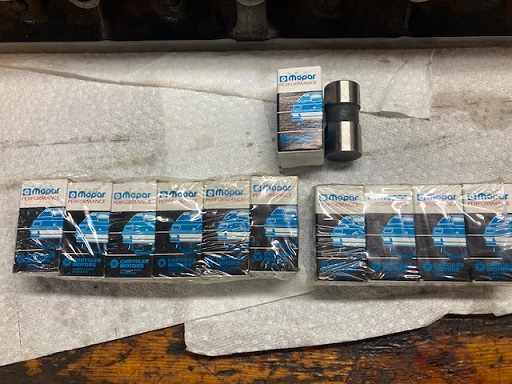

Also posted photos of the NOS Mopar hydraulic lifters, part number P4095897, per the box 1988 vintage, set in to match up with the NOS Mopar cam.

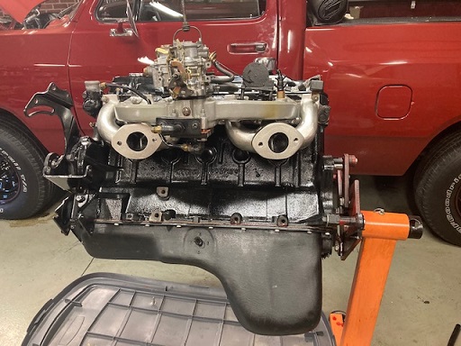

Other good news is the motor is ready to go back in chassis.

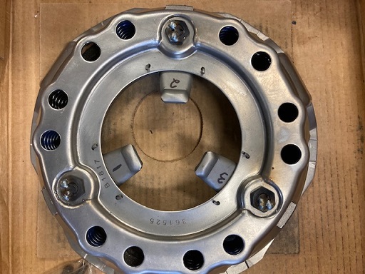

back on the real reason I needed to pull the motor in the D150,, increasingly difficult to shift, clutch engagement issues.
the first photo below is the new pressure plate that is going in, as recommended by Josh, I have put a touch of a spot weld on each of the adjusting bolts.
The other two photos are of the adjusting bolts on the pressure plate that is being removed. With that pressure plate bolted up to the flywheel there is nearly 1/4 inch height difference between the three clutch plate fingers where they would touch on the TOB. A closer look at the adjusting bolts, shows that the staking that was to hold the adjusting bolts in place was too light to be effective. The stake mark did not intersect into the threads of the bolt.
That pressure plate was likely properly adjusted when it was installed. Over time with use the adjusting bolts and fingers moved. I do plan to take this PP back to the seller (NAPA), it is past the warranty period, but also is an obvious example of a manufacturing defect. I have experience pushing rope up a ladder, I will see where this goes.

John, what is the brand / manufacturer of the New PP that you are placing in service? Looks slightly Different Thant the typical Borg & Beck 10" Unit if I remember correctly...
